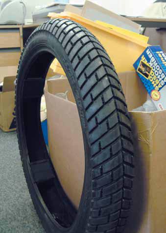

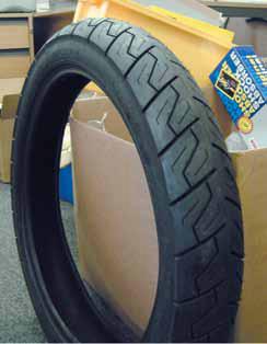

Postby radiograf » Sun Oct 07, 2012 11:15 am
I use Cougar tyres all year round on my Kawasaki ER5 and Bmw R100 GP12 on front. GP11 on rear. Cheap too.
