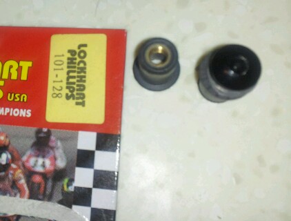

After ten years of fighting not to replace them, I found them at my local MC shop. They are lockhart phillips 101-128 they come with black screw. It says it's for windscreens, but they are perfect fit for the baggy\mastiff :-D they came 8 in a package so if you would like to get my 4 spares I'll mail them to you US only for $5.60 just PM me for paypal or chasepay

are they plastic or metal
Re: baghira front side panel Well nuts
Postby m4panther » Sat Sep 08, 2012 6:00 pm
They are rubber with metal nut just like our originals

This is what I have. Black 5mm allen heads rubber well metal nut

The link you posted, not the same thing, they seem to not have the brass inserts/nuts. SKU 101-101. m4panther's pic shows SKU 101-128. i searched for 101-128, not found. Not on the Fasteners product page. I'll try a google search of the site now. ...No result. Also, i see m4panther says black Allen M5, but the 101-101 pic shows black slotted screws.
PS:
LP USA's aluminum windscreen screw kits bring a high quality detailed look to any bike.Each kit includes eight buttonhead screws, clear washers and either regular nuts or wellnuts.Wellnut is 6mmx10mm.Choose from six popular anodized colors.
...But the item page does not have any option to select colour.
