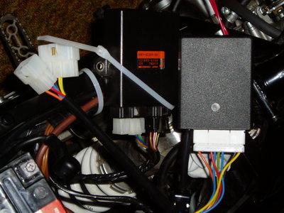

Yes that is the stock box.
This is an Ignitech Sparker I set beside the stock box for reference. Note that it's case doesn't have the mounting points that the stock unit has. Though the size is close you'll have to figure mounting it in some custom fashion.
Also the price has dropped since I bought my Ignitech Sparker, around $200. US.
Regards,

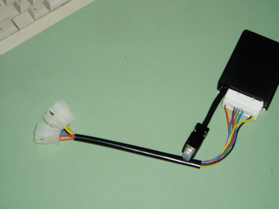

Postby OLDMTNCARVER » Sat Aug 11, 2012 11:32 pm
Here's a clearer picture of the Ignitech Sparker that some folks on this forum use.
I would suggest reviewing Bill's Blog and other posts on this forum for tune information.
OMC

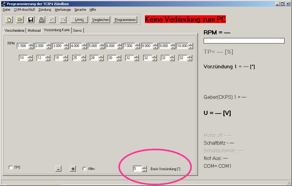

Postby OLDMTNCARVER » Sat Aug 11, 2012 11:58 pm
I found this picture showing advance curve and rpm imput points.
I don't know if this is an example of factory shipped or tuned for better performance, it's just an example.
Robert

Postby edfmaniac » Sun Aug 12, 2012 1:16 am
This post has the curve of the stock box as well as the curve that comes on the ignitions that Bill sells.
viewtopic.php?f=3&t=5722&hilit=curve
So far my best results have been to mirror the stock box up to the 24 degree @ 3000rpm mark. My next point is 39 @ 5000rpm and then a linear curve up to a maximum advance of 43 degrees @ 8500rpm. If you have a high compression piston in there, you may want to work your way up to the maximum advance.
