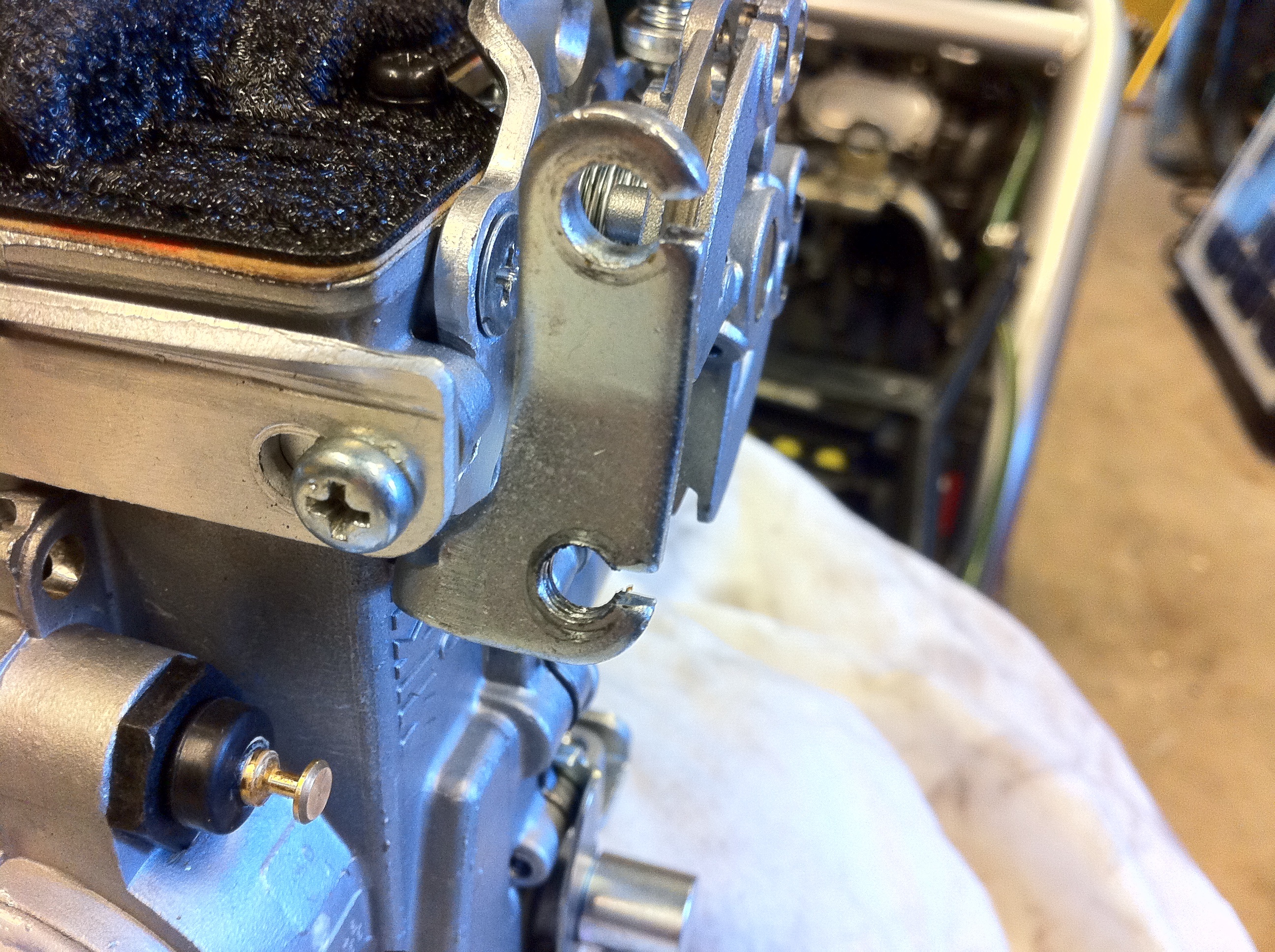

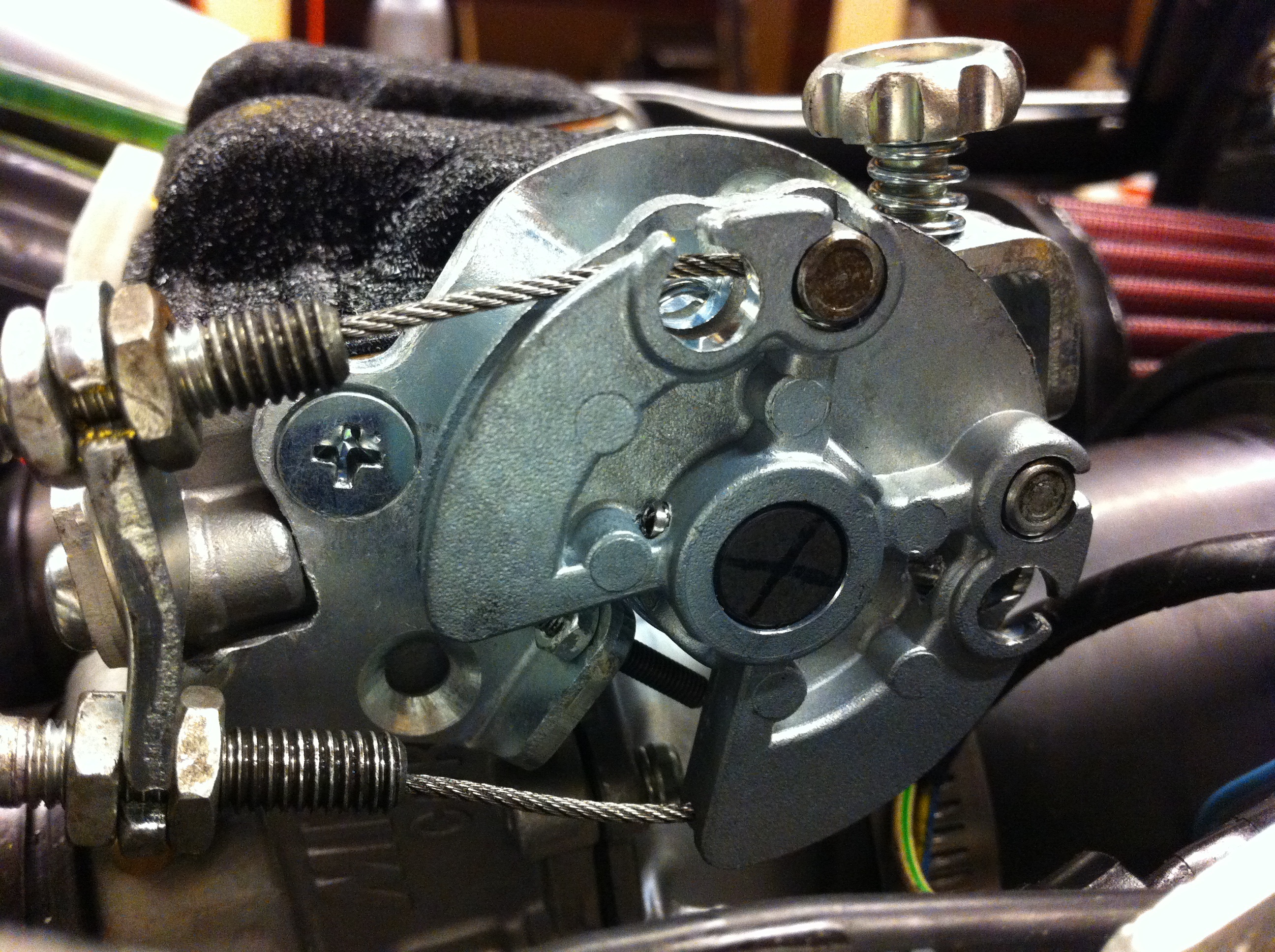

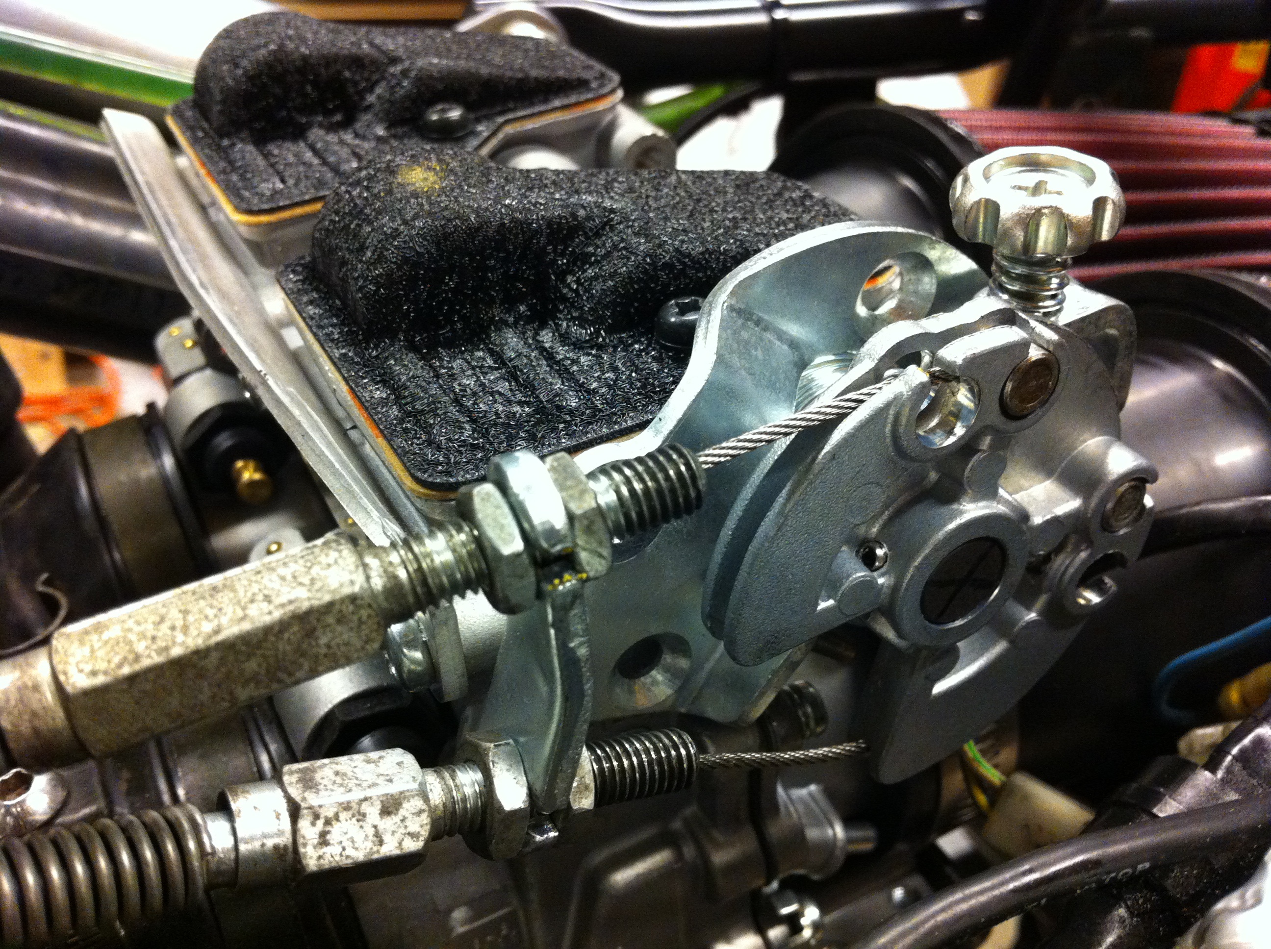

The cable mount is made just by rotating it about 45 degrees, therefore two new holes were made and some cutting to get some space around this screw mount in front. The large truss in front is shifted to the left position. The cable holder even has a small bulb right where it shoul be for the new hole. What surprises me is that no one seems to turn the "cable wheel" as well, although a proper alignment along the radius is only possible if the cables and cable wheel maintain their relative position. So i drilled new holes to mount the wheel about 45 degrees shifted. Afterwards the idle screw was shortened for some necessary headroom under the skorpion tank.

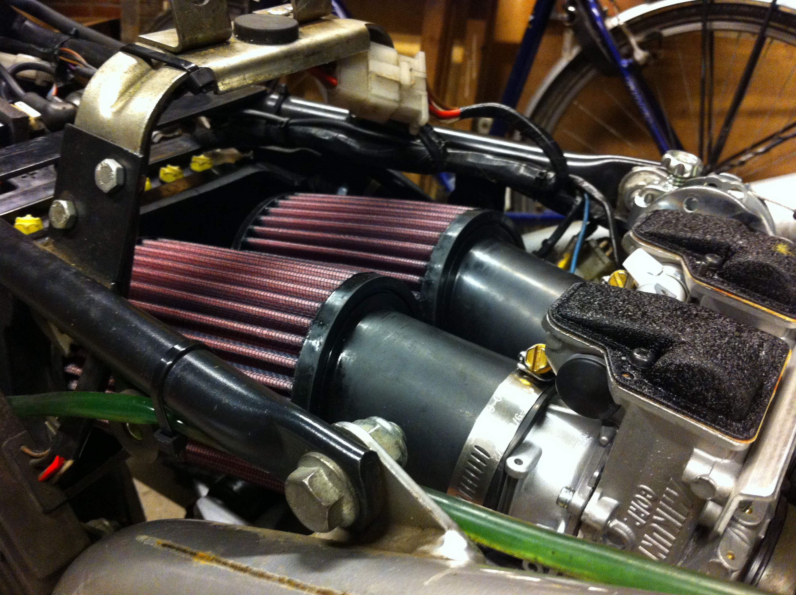

Furthermore i installed two K&N RU 1780 filters. They are huge!
They have 52mm flanges, but fit easily around the 54.8mm carbs. The long flanges also form some kind of a velocity stack. What effect it will give is guessing, a dynorun is planned after fitting a high comp piston and flowing. We'll see.

Can you post a few more pictures of the cable bracket from different angles. I just want to see how the the bracket has been modified from original. How did you change the aluminium bracket/rail that holds the two carbs together? Do you still have enough room for the choke lever to work?

The rail in front of the two carbs can be shifted between two positions when unscrewing the four bolts completely. This is necessary for repositioning the bracket. The rail doesn't need cutting or welding because it isn't part of the repositioned cable holder.
Tomorrow I will take some pictures, but i can already tell you there is no space for the original choke lever.

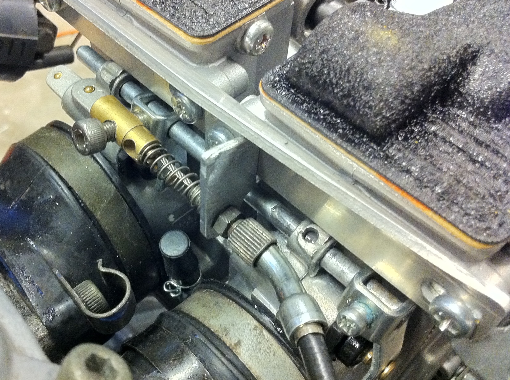

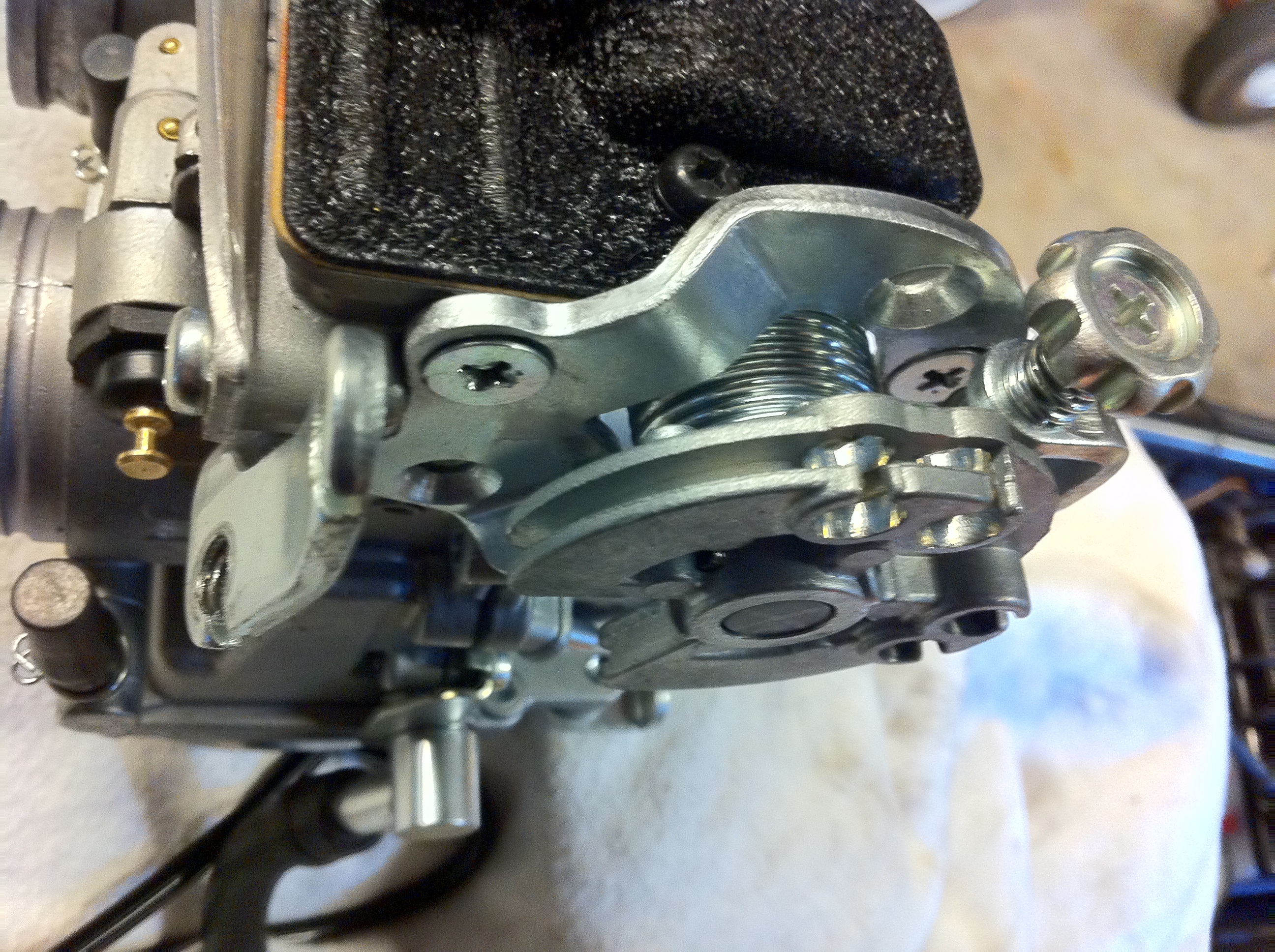

Postby Hajok » Sat Oct 27, 2012 1:14 pm
As promised some pictures:
Also made a 1.0 version of a choke control using the original lever and cable. I found some parts of an old Dellorto carb which are bolted onto the right carb choke. Made to be functional, the next version will look better.
Read my rambling at MuZ ManX

Re: Fitting a TM34-B65 carb to my Skorpion
Postby zippy49 » Sat Oct 27, 2012 3:34 pm
Hi guys,
Funny that I am trying the same installation right now, posted here in the tech talk board. I like the ideas presented here, especially the choke cable. But I'm waiting to hear how your fuel tank(s) fit...I had to move the cable holder as far as possible to the right before the tank would even think about dropping into place. I even took off a bit of the connector bracket, screw, and the boss it screws into. And since I want to use the airbox, I've ordered jets down to #90...
Postby Hajok » Mon Oct 29, 2012 3:04 pm
zippy49 wrote:Hi guys,
Tom in SoCal

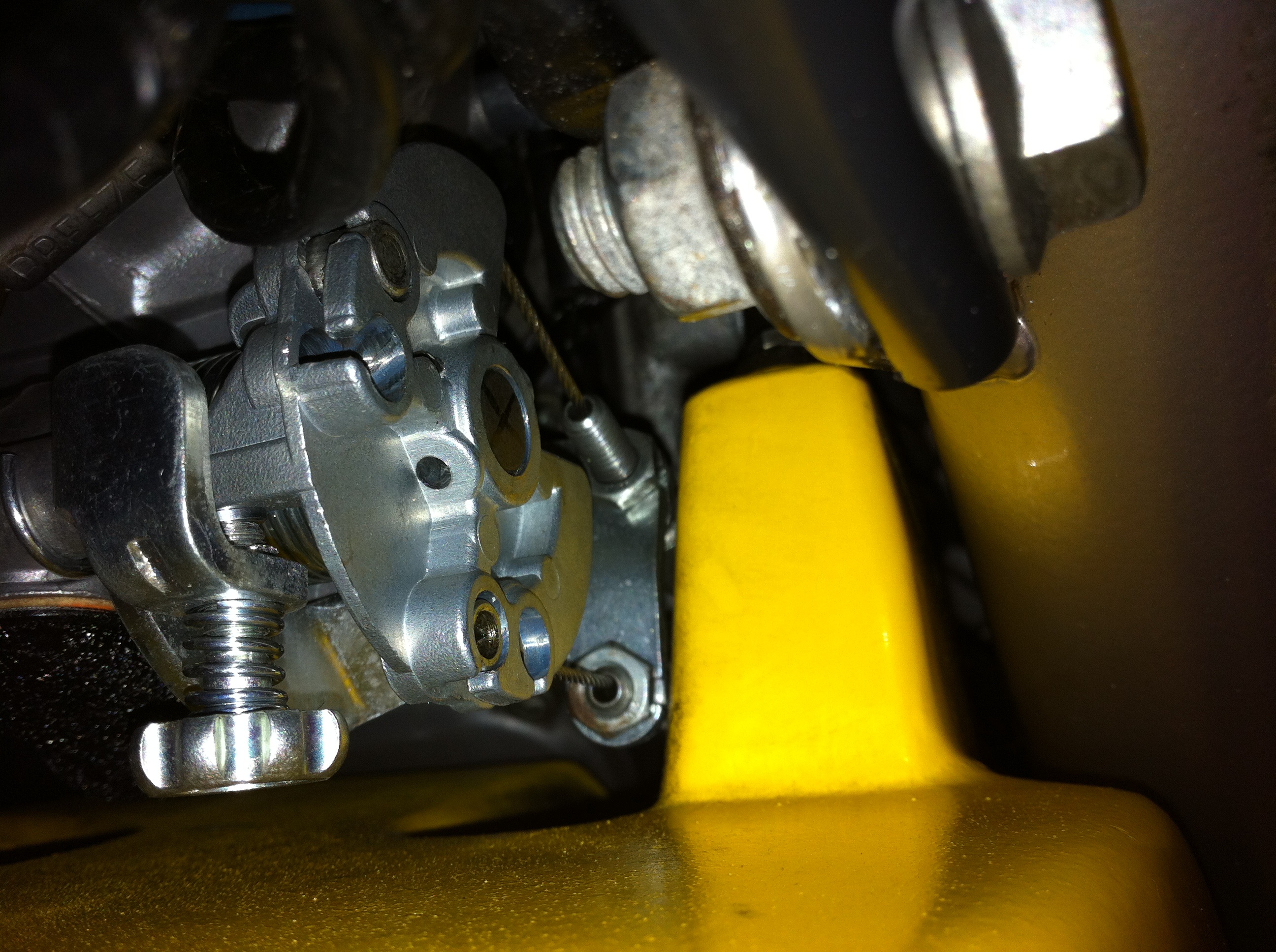

Here a picture of the tight space beside/under the tank:
Not a lot of room, gently dropping the tank pushes the carb a little sideways when the petcock hits the frame. Doesn't do any damage though. When the tank is fully seated there isn't any interference. The cable bracket zippy49 uses sits higher, therefore hits the slanted side of the tank (this sump thingy).
Lowering the bracket meant the choke knob had to be removed completely,the rod has been cut as short as possible to get enough stroke. I even bent the levers pulling the chokes to gain some extra. Yesterday the proof of the pudding, starting quite easily at 3 degrees C./40 deg F.
