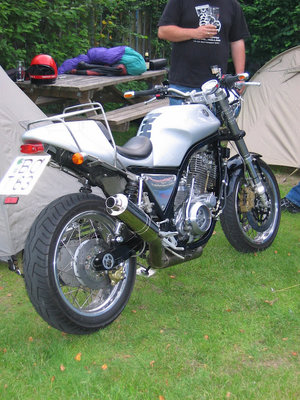

So everyone talks about swapping the heavy alloys for lighter rims which of coarse make perfect sense but what about a real traditional steel spoke cafe racer retro look? Has anyone done it as I fancy the look? I have a spare pair of mz125sm (lighter than standard incidentally)rims but the shafts are wrong so I want to borrow beg or steal some 17" baggys. Any viewpoints as brake calipers need to be different too? Eric

there have been a few such rebuilds. I loolked for some photos but found nothing at the moment. I did find this of a modernized SRX
which would come very close.

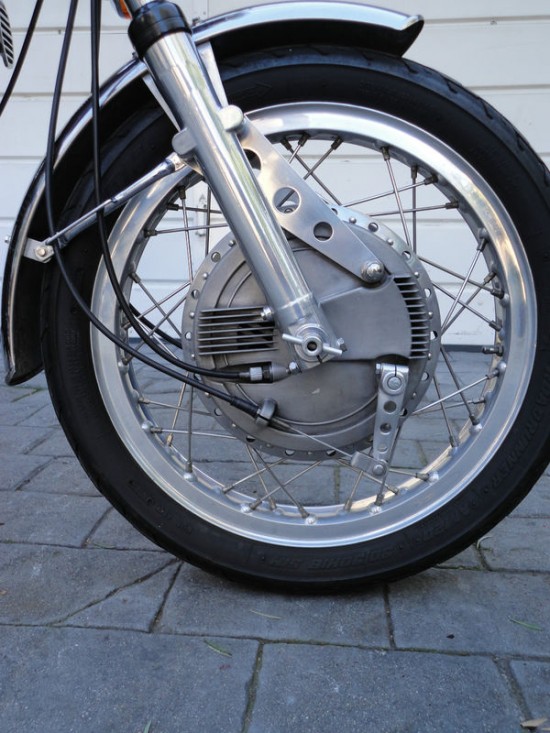

I would not waste time trying to find wheels that might fit from other bikes, especially not from enduros. Rather find hubs first, used of new that fit the fork (rotor side and alignment) and swing arm. At the back there are many drum brake possiblities from newer japs with wire wheels. Before I would begin to change everything up front to accomodate an ill-fitting hub, I would make my own hub to fit as is; it is a very simple exersize at the lathe and drill press (or milling machine , better is available). Once you have reasonable, light hubs, lacing in decent rims is the smallest problem and definitely better than finished OEM wheels. In particular that lets you fit a narrower rim at the back for a 130 or 140 tire. All of the 17" enduro or supermoto wheels are much too wide. there is absolutely no reason not to use a drum at the rear.
If I were doing it, I would seriously consider fitting a drum brake in front as well. A good drum, well maintained ( and that is the crucial point) is at least as good as a disk. It's biggest problem is fading and that is not an issue on the street. That and maintenance; a drum need regular attention and the best in cables.
Maurizio has a some very nice ones:
http://www.motocicliveloci.it/italiano/catalogo/frenitamburo.htm
hubs for disk brakes as well (bottom of page):
http://www.motocicliveloci.it/italiano/catalogo/frenidisco.htm
Motocicliveloci has lots of goodies.
Two or three japanese OEM drums - a Honda duplex come to mind - would be fine as well.
As I said, if I were doping it.
I would not, however, because wire wheels are too heavy and need too much care for everyday use. They are not used on any street bike and that since decades for very good reasons, the least of which is cost. they are used off road becuase they are flexible and forgiving but this is not an argument for street use.

Bill, I 100% agree that the best way to put a disc wheel on a modern bike is to fit/build the hub and work up from there, but have to disagree on several points regarding drums. Drums can be made to engage as easily as even the best disc wheels; I can make the 4LS brake on my TR500 road racer a one finger brake, and on that beast fading is no problem. But even the best brand new cables don't give you the feel of hydraulics, and more importantly, the combination of stiction and camming action of a drum makes it impossible to lightly decrease braking force when they are already applied - if you have too much brake you have to back off conpletely and reapply. This isn't much of a problem for even sprited street riding but is a major PITA when racing.
These two things can be mostly mitigated - I regularly ride a drum braked bike on the street and the brake is fine, but you just cant get a drum to perform nearly as well as discs on the race track. Then there's maintenance - drums take a world more, what with lubricating pivots, and multiple adjustments...and they *need* to be maintained in order to work well. That all said, I do agree they're fine for the rear where braking feel is not as important, and the consequences of forgotten maintenence not as dire.
As far as weight - spoke wheels, they can be made lighter than all but the lightest of cast wheels, particularly if you build your own. But they cant be made as stiff, and the lighter you make them, the more maintenance they need: thin spokes and alloy spoke nuts weigh practically nothing, but stretch.

I have raced drums, Oldani and Fontana (real ones, not replicas) and am well aware of their ideosyncrasies.
A good drum is very much a 1-finger brake, much better than say any of the contemporary disk brakes, e.g. the Brembo 08s on the Laverdas (and Ducs and...) that repalced the the rather good Laverda drum. Those 08 calipers are two hand brakes (one fist is not enuf) along with a (beathtaking in the strictest sense of the word!) long stopping distance; I have had more scary moments with those than I care to think about.
the cable and its routing is all-important. And the angle of the arm(s) on the brake plate. the is important for control. And the maintenance, not just the greasing of the cams and oiling of the cables. We checked and if necessary refiled the shoes, checking with chalk, between each run. You have to if you want the drum to brake right.
Although the late double duplex monsters like that of the Yamaha 250 are real killers,
I prefer a good double simplex myself, much more controlable.
The Morini 3 1/2 brake is a really good example and one that with luck you might actually find.
or one from a Laverda.
Or lacking that, an Oldani
