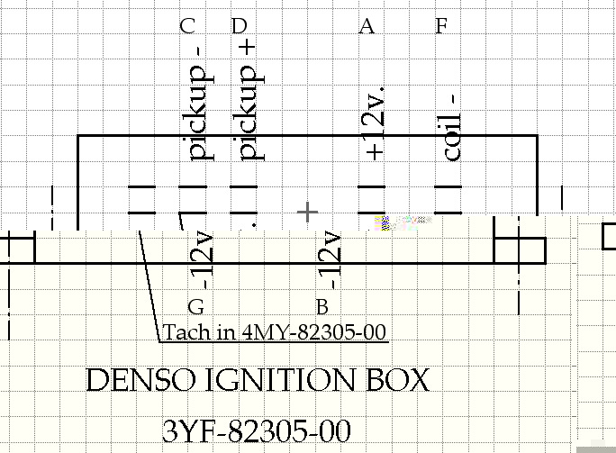

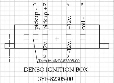

I have a Baghira which I acquired as a project. The wiring under the seat is a bit of a mess and the 4 pin connector block that goes to the CDI or ignitor is missing. Can someone tell me which wire goes to its respective terminal and how many wires are actually on the 6 pin connector which sits next to it.

Postby Bill Jurgenson » Sun Jun 17, 2012 12:40 am

Thanks Bill- exactly what I needed.
