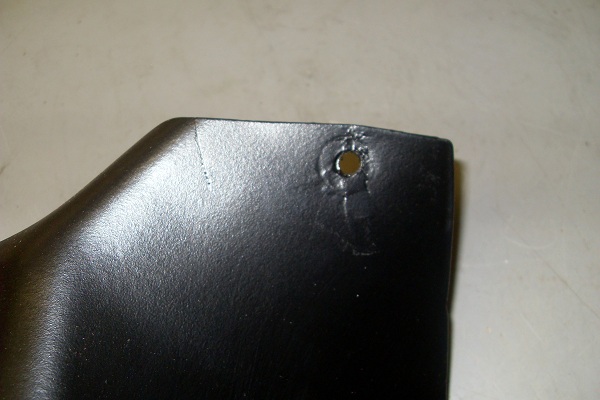

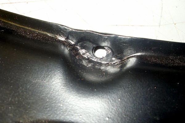

Postby Norman Wade » Sat Jun 09, 2012 10:46 am
To repair the fairing I bought a sheet of 2mm thick ABS from Ebay UK. This is fairly cheap, at the moment an A4 sheet (printed to look like carbon fibre - woo!) only costs £6. http://www.ebay.co.uk/itm/CARBON-FIBRE-EFFECT-ABS-SHEET-A4-SIZE-2MM-/251013623282?pt=UK_ToysGames_ModelKits_ModelKits_JN&hash=item3a7193edf2
To glue it I used cement used by plumbers to join PVC and ABS pipe. http://www.bostik.co.uk/diy/product/evo-stik/PVC-Pipe-Weld/126 In the UK you can buy this in hardware stores (I got mine in B&Q). In other countries similar products will be available.
I cut 'patches' of ABS to fit behind the damaged parts of the fairing, roughed the areas to be glued with fine wet and dry, gave them a wipe with alcohol, glued them, then clamped them until the glue hardened.
Once it had hardened (I left it overnight), I gave the visible side a spray with satin black to see how good it looks.
Bottom mounting hole:

I made a patch across the broken mounting hole and also a strip across a crack.
You can still see the cracks, so I'll add some filler and respray it.

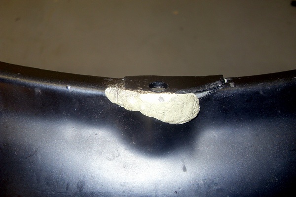

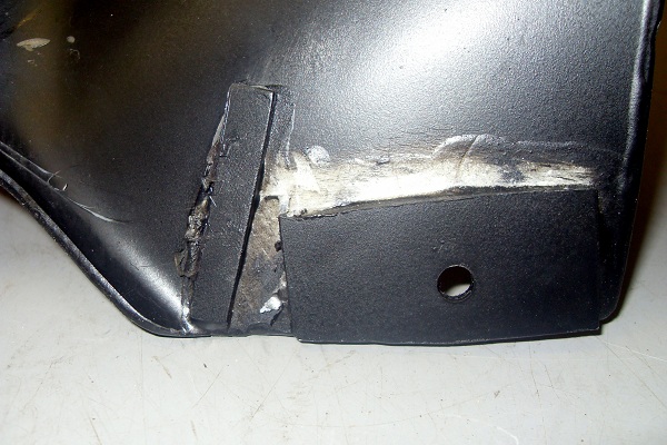

Postby Norman Wade » Sat Jun 09, 2012 11:08 am
The top mounting hole had broken away completely, so I made a 'bridge' from ABS and glued it in place. Once it had hardened, I filled the missing area with 'Milliput' putty, sold in modelling shops. http://milliput.com/prod.htm This is a type of epoxy putty, which although it worked, took a long time to harden properly (about a week).

I shaped the Milliput to follow the line of the fairing.
I'll smooth this a bit more and respray it.
As an experiment, I tried to prise the patches away from the fairing with a screwdriver, but the plastic would have broken before the patch came away, so it looks strong enough.
To try and avoid the cracking happening again, I made rubber washers out of an old inner tube and fitted these behind metal washers on the nuts and bolts holding the fairing together. Let's hope this works!
