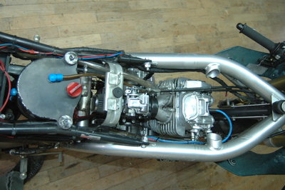

And that is with my own prototype frame that was rejected by the engineers at MZ as being too weak. So weak in fact, that I subsequently removed the cross tube above the engine to get rid of that nuisance and finally be able work unobstructed and not have to remove or at least tilt the engine for even the smallest tasks.
With NO noticable effects whatsoever.
