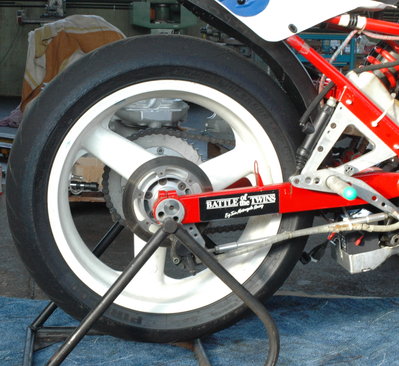

Although I have never had trouble with the Skorpion with this, I had
big trouble more than once with the Yamaha, so I modified both as in
the photo.
Apart from the 15mm axle, you will need to make two simple collars to
reduce the chain tensioners to 15mm, slightly oversize and press in to
stay. For myself, I made the collar on the right side a loose fit in
the tensioner, but made is long enough to press fit into the brake
plate.
here at the left. You also need 15,5mm ID washers of course; I made
quite thick ones from stainless.
That way, The brake plate with spacer is attached to the swing arm and
does not fall off or get in the way when mounting the wheel. Far easier
and quicker that way. Of course you have to remove the caliper first
before removing the wheel but that is normal, anyway. Or should be. Cut
the right side of the rear fender short on the swing arm up to the
mounting screw so that the caliper bolt is not covered. Another of
those little things, the guys at MZ didn't pay attention to! The SZR is
FAR worse, though, since that front caliper bolt is shrouded by the
swingarm and cannot be undone at all. Talk about not thinking for two
cents! Race mechanics generally stick the axle from the brake caliper
side; with the stock SZR you have to stick it from the chain side so
you have room to fumple the brake plate with caliper onto the rotor
after the wheel is hanging on the axle, sticking the axle fully through
at last. Normal people bolt up the wheel first and then remount the
caliper. Many units, designed for long distance racing where tire and
brake pad changes (pit stops) are quick release or fold up
designs. No one fumbles a wheel into a premounted caliper, neither rear
nor front.
