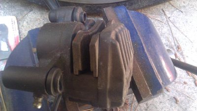

Postby amahoser » Thu May 17, 2012 12:18 pm
My front caliper for my Baghira is leaking and needs a rebuild kit. Grahams, SF Moto and Bikeworx do not have them in stock. I fear that since MZ is gone these will be hard to source. Are there any good aftermarket or oem alternates for the caliper on a baghira. I searched this site and saw that Brembo P4 30/36 seems to be the upgrade caliper for a skorpion but that is a 4 pot caliper and mine is only a 2 pot. Will it work without clearance issues? Any other calipers that I should be looking at?

Postby Bill Jurgenson » Thu May 17, 2012 2:04 pm
if it's not too much to ask, I suggest looking a few threads down:
http://www.mzriders.com/viewtopic.php?f=3&t=5874
The front clamp is not two piston. It is a 4 pot floating caliper.
Re: Baghira front Caliper
Postby amahoser » Thu May 17, 2012 5:13 pm
I saw that thread. He is pretty much asking the same questions that I am asking. Is this a direct fit for the Baghira? Does it need a new bracket? Will the 4 pot caliper clear the wire wheels?
I also saw your excellent write up on the Brembo Master Cylinder thread. Great job and very informative.
However that information is for a Skorpion and not a Baghira. You specified a P4 30/34 r which I believe is the right side caliper. On my Baghira, the Caliper is on the Left side. Also my Grimeca Caliper is(for sure... just double checked) a 2 piston caliper. I believe the Skorpions use a 4 piston one.
I am willing to try a p4 30/34 but I was hoping for confirmation before spending the money
Postby Bill Jurgenson » Fri May 18, 2012 2:08 am
nope
this is a two piston caliper
and so is the rear brake of the Baggi.
The Baggi has a floating caliper which does have only two moving pistons but they are next to each other pressing on a wide pad and opposite a similar pad on the other side of the rotor, i.e. what amounts in terms swept area to the same thing as a 4 piston caliper like the P30/34. this is the Brembo of which the Grimeca is a bad copy:
Whether the left or right side is immaterial; both sides are dimensionally the same.
Like I said, do your home work like everyone else has to.
There are so many Baggis and KTMs that were converted to P30/34s , it must be possible to find photos galore.
I don't have nor ever had a Baggi or KTM. Nor do I want any enduro, so I have to do homework, too.

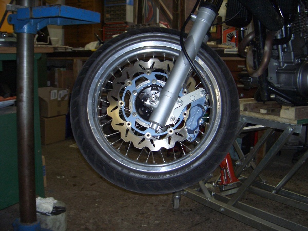

Postby Meeners » Fri May 18, 2012 1:53 pm
amahoser wrote:I guess I am a bit confused. Are you now saying that a two piston caliper side by side can be called a four piston caliper? You originally stated that the Baghira has a 4 piston caliper and now you are saying that two pistons side by side has the same swept area as a four piston caliper. So are you saying that when I look at my caliper and I see only 2 pistons side by side I should refer to it as a four piston caliper?? So there is no confusion my front caliper is a two piston side by side and my rear caliper is a single piston.
And YES I have seen pictures Baggys with 30/34s but I don't know if there was any modifications done in order to fit them. SO my question still stands.
I'm sorry if I upset you or something. I thought I did my homework but for whatever reason you don't think I did.I cannot find any info that says that a 4 piston p30/34 will fit a baghira that has 2 pistons side by side WITHOUT modification. I am almost sorry I asked on this forum. Geez, next time I should just keep my questions to myself.
Jose Soriano
Jose, I understand... I'm trying to find the same information but all the info that is around is dried up and/or a broken link, or in a different language. I understand your frustration, believe me. It's a little different for a Baghira... I just purchased a setup from a 1996-97 KTM 360 to see if the brembo bracket will fit our bikes, and to see if it can be a replacement. It's not the 4 piston p30/34 and it looks similar to what we have.
I will let you know what I find. If you want you can post in my thread to keep all the information in one place so people in the future can find it. I'm putting together a document that has all the baghira information I have found over searching for the last 6-8 weeks. As soon as I get some solid information on brake upgrades I will post it.
Postby Meeners » Sat May 19, 2012 6:57 am
Bill thank you for the nformation... The thing that sucks is we still have to do quite a bit of purchasing and playing around to figure this out I.e. it's not clear what we need to do to get the parts to fit correctly. Not complaining at all, it is what is. If someone has done it before, they definitely haven't shared their procedure.
What that means is we have to do a lot of purchasing, and buying the wrong parts to come to a solution, which were trying to avoid by searching and asking questions. But were getting all the same responses. I know it must be frustrating on the senior members here because it feels like they are reposting information that has been displayed before... But I can promise you I've searched to my physical extents. There is no solid info for the Baghira.
For instance, this guy below got it to work and I want to ask him what he did but he is long gone
viewtopic.php?f=13&t=3616
Jose... Just buy the p4, or p30/34 and well get it to work... It's probably really easy... I'm gonna bite the bullet here and just buy it.
