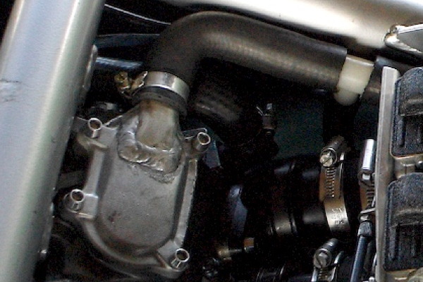

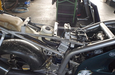

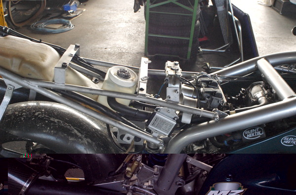

here again, my top vent, 1" cooling hose, the smaller hose from below jointing the 1":at the white delrin T-fitting.
the scouring pad in the lid of the catch tank is a sort of "airfilter" for that tank to catch the oil mist inside and keep it inside.

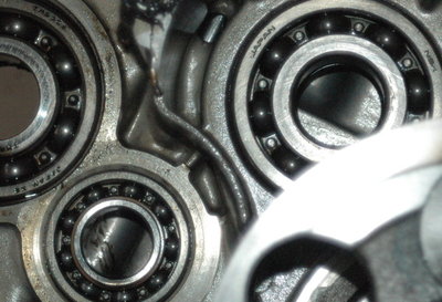

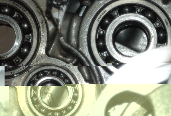

the stock vent goes thru the balancershaft
whose most important purpose is that of a centrifugal separator. There is little point in placing a larger hose here because the "separator" cannot be larger in ID.
OVER used the much larger hole behind the OEM vent for a second very large vent hose. That hole is for the clutch arm in the pre-XTZ versions (XT, SRX, etc). You can see thru the mainshaft bearing to the space for that clutch arm. So, OVER must have milled that cavity free from the flywheel side. I've not seen the insides of a real OVER motor so can only guess.

And since making my own round oil tank for the Skorpion, I no longer have that problem with it, either. In fact the the purpose-made vent tank I use on the MZ is always practically empty.
under the seat, just visible at the right
