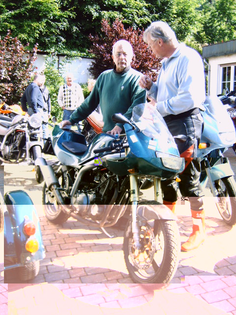

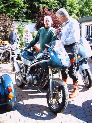

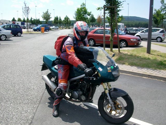

The exhaust ports of the aircooled 4-valve heads (these are all the same) are different to the 5-valve head; they are parallel pointing straight forward and the 5-valve are splayed to the outside. This difference is due to the cooling; the water-cooled head does not need fins close up. That said, I bent the Skorpion L&W headers together to fit the air-cooled head
until I found the Devil TT system I now use. Sorry I don't have any decent shots but it was always only temporary.
Kosta uses the 2-2 Replica system on his XT600E Skorpion.
