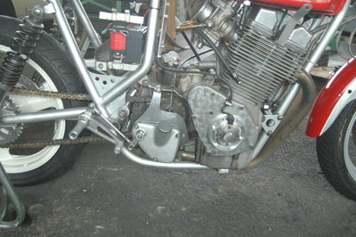

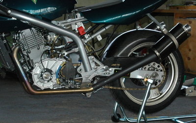

If you are serious about the track, then you should ditch all that and run a constant loss battery ignition. Then there are several to choose from. Or you can go for a magneto and ditch the battery, too. I ran a PVL magneto for all but the last season
here with Barker's milled side plate on my engine; no flywheel at all.
Barker's championship winning SZR (back a bit!) ran with a PVL magneto, a downdraft head and ram air airbox.

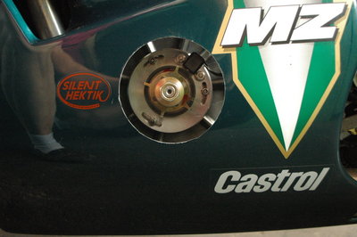

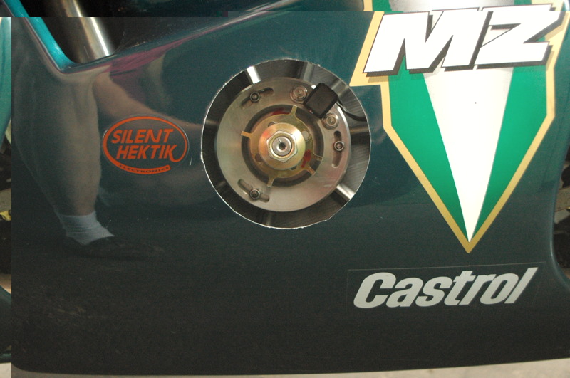

then I changed to a SilentHektik battery ignition

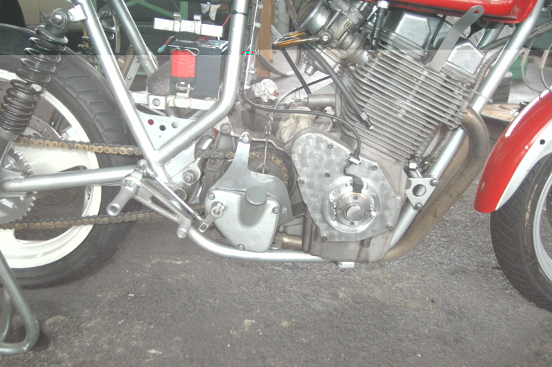

the same ignition mounted on the 1200cc 3 cylinder Laverda I race sometimes
You see the small induction wheel and the pickup mounted on an adjustable ring to set static advance.
