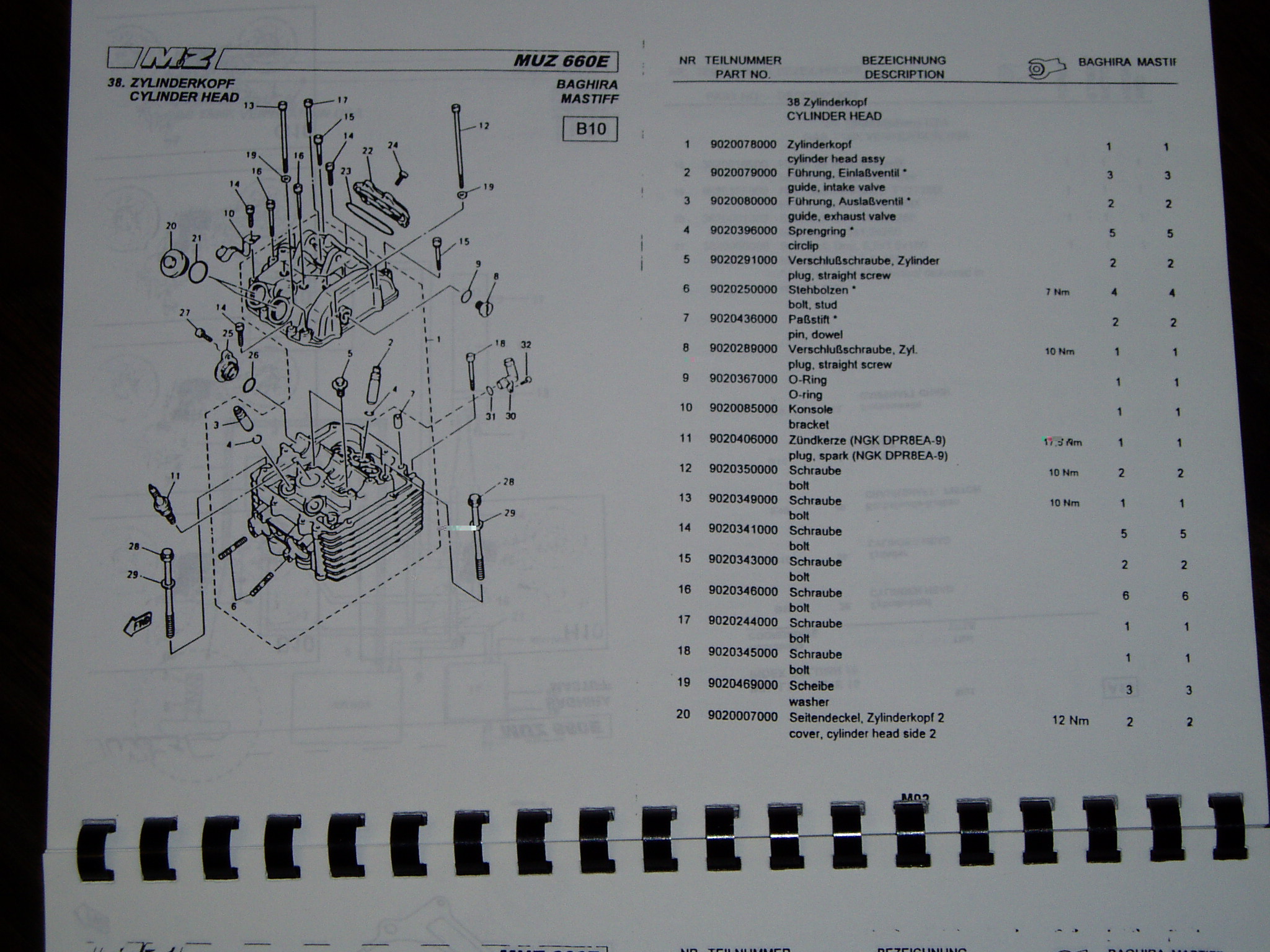

Alg,
If my old eyes are working... 7 Nm.
Check the picture, enlarged of course...
OMC

Postby Alg » Mon Mar 05, 2012 5:24 am
Thanks OMC.
7Nm however is the torque setting.
Each "exploded" drawing I find lists part numbers but not the sizes so I guess I'll carry on searching the net for the answer.
Thanks for trying to help.
