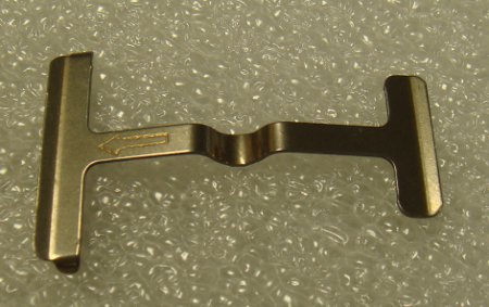

After a few days of trying to decide whether or not I want to spend $200 to get rid of the rattle in my front pads, and doing a lot of shopping, I've come to the conclusion that the Brembo caliper on the 02-03 Indian Chief is the same as the one that fits the Skorpion. If that's true, then the anti-rattle spring for that Brembo should work on the stock Grimeca, I THINK!!! So I went looking and found some.
I ordered one from this site and will let y'all know if it works.
http://www.aardvarkcycle.com/store/50-068-brembo.html

Postby Skorpion660 » Wed Mar 07, 2012 4:32 pm
Spring arrived yet and tested if it works?

Postby edfmaniac » Wed Mar 07, 2012 5:47 pm
The spring isn't an exact fit but I'll make it work in my case. :wink: Get the Brembo caliper.
If you want to give it a try, just take a sanding drum on your rotary tool and take off tiny bit of caliper material where the wide end of the spring makes contact.
