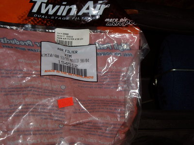

Postby OLDMTNCARVER » Sun Feb 05, 2012 10:53 pm
Frank,
I feel gutted hearing your curcumstances.
The filter you need is a KTM unit Picture provided.
If you have need for anything else ask. The folks at this forum are of good heart.
Best wishes,
Robert

Re: Baghira Air Filter
Postby kman.45 » Mon Feb 06, 2012 9:59 am
Note: All cross-references based on Twin Air OEM filter being that used for the KTM models listed here under Twin Air.
Twin Air (OEM) http://www.twinair.com/
154512
(KTM 400 LC4 93-99, 600 LC4 93-99, 620 LC4 94-99)
UniFlow / Unifilter Australia http://www.uniflow.com.au/
NU 1405ST
(KTM 600 LC4 93; 400 LC4, 620 LC4, 640 LC4 93-01)
(unconfirmed)
Moose http://www.mooseoffroad.com/
M762-50-02 www.mooseoffroad.com/pdf/AirFilters05.pdf
(KTM 400 LC4 93-99, KTM 620 LC4 94-96
2003 Baghira 660 SM/E
2008 Ducati Multistrada 1100S
kman.45
Posts: 184
Postby frank33m » Tue Feb 07, 2012 6:40 am
Thanks for all the info but all the numbers seem to be absolete . I used the KTM models to find one at Cycle Gear . Again thanks for the help and I'm sure I we have more questions down the road . Frank
