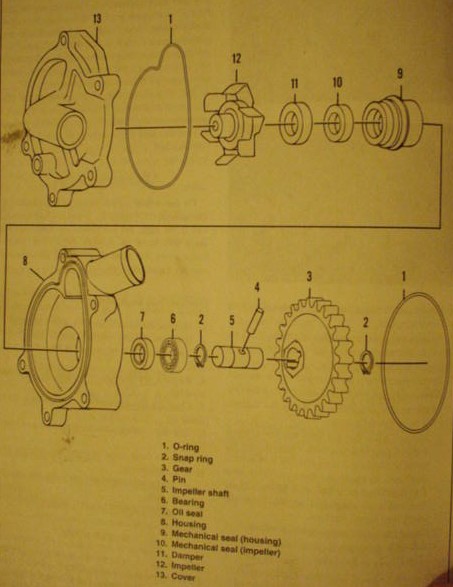

Postby ironhorse99 » Mon Jan 30, 2012 10:54 pm
I've loaded a diagram of the pump. Hope its of value to those making their own repair.
MZ Water Pump Diagram

Postby edfmaniac » Tue Jan 31, 2012 2:44 am
Thanks for the part numbers, heads up on your difficulties and general explanation of the weep hole situation. Mine leaks intermittently right now so I'll just keep an eye on it until my top end gets juiced up a little in a few months. The reservoir is still full and I haven't had to put any fluid in it since I bought it almost 10k miles ago.
