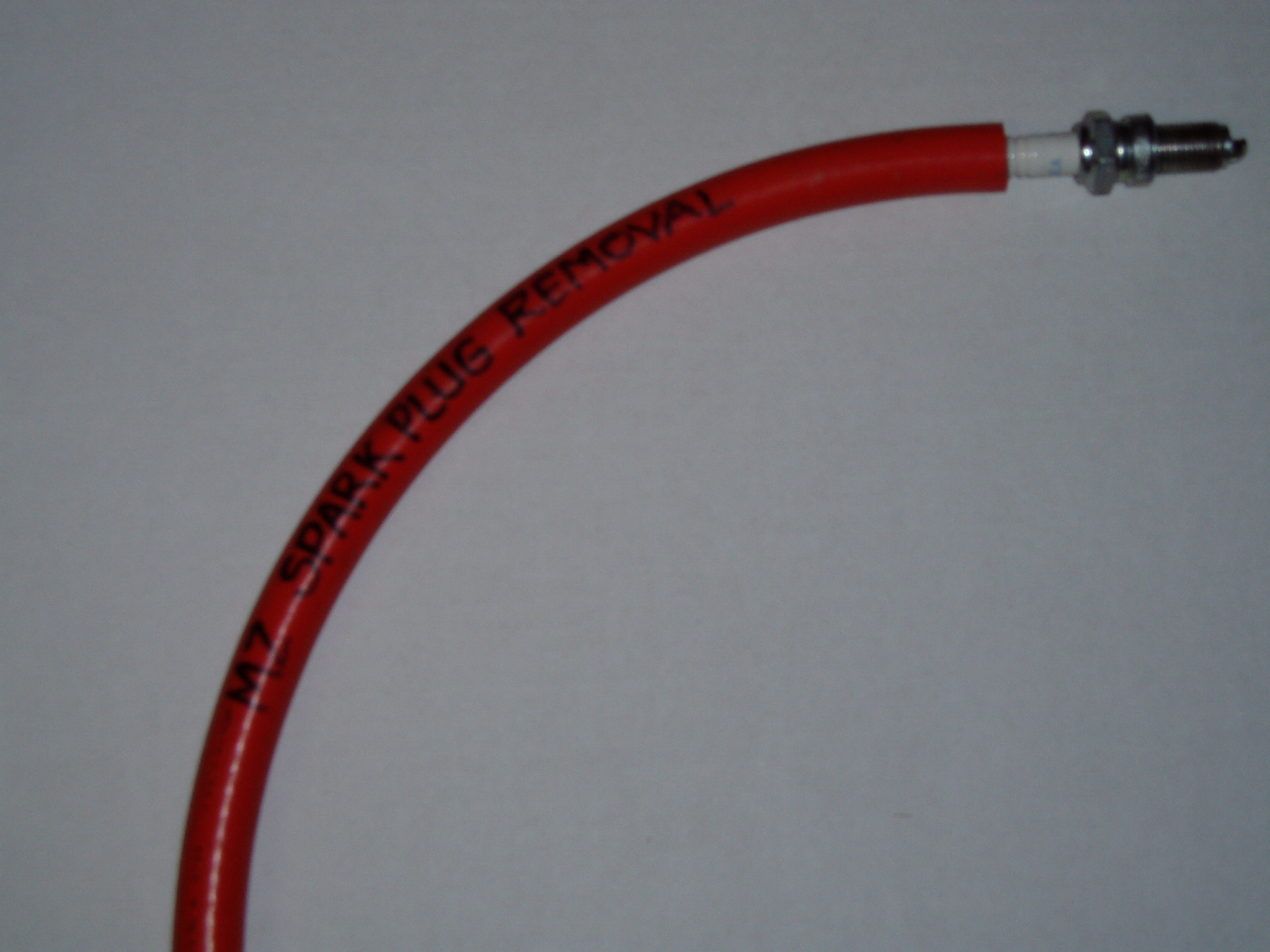

Gordon,
I use a standard style deep socket that does not have the rubber liner that helps hold the spark plug in the socket.
If I did, the spark plug would stay in the socket and extension. The result would be an assembly that is difficult to remove.
Using the standard deep socket allows me to break loose the spark plug without unthreading it and then remove the socket and extension leaving the spark plug loose but in place.
I then get a 3/8 inch hose, roughly 12 inches long that I slip over the exposed end of the spark plug and finish unthreading it.
For installation I reverse the process.
Note that anti-seize is used on the spark plugs threads.
Regards,
Robert
