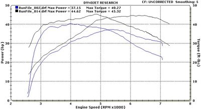

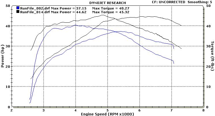

Postby harold » Tue Dec 13, 2011 6:09 pm
I posted some dyno charts in a previous post. To those that didn't see it, I had an 11:1 piston and a HotCams stage 1 cam put in. I already had installed a Mikuni 42 mm HSR. I got this chart today, and it shows torque and Hp, stock (with Mikuni) and with the new parts. I never had it dynoed when the carbs were stock. The cam moves the power band just a little up it seems, so the peak RPM power goes up more than at 5,250. It isn't anywhere near the 50-70 Hp figures I have heard about, but I think they had more work done.
Overall, it is noticeable, but mostly at higher speeds. With the abundant low end torque, a stage 2 cam would probably be a good runner. They require different springs, at the least, and so up the cost another step.
The next step is a lighter front wheel, and maybe better front caliper.

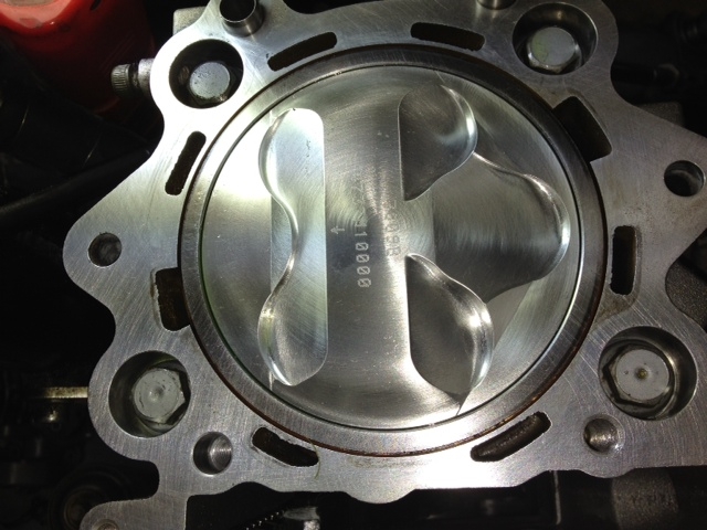

Here is a picture of the 11:1 piston. A little different than the stock flat top, and born ready for higher lift cams.
harold
Posts: 116
Location: Gainesville, FL
Re: Dyno chart, 11:1 and stage 1 cam
Postby chisleu » Wed Dec 14, 2011 7:49 am
Now that is pretty! :)
That is not a lot of clearance to the head! Any pictures of that piston from the side? Wondering how much clearance from the wristpin to the bottom ring.
chisleu
Posts: 143
Joined: Wed Oct 12, 2011 8:29 am
Postby Bill Jurgenson » Thu Dec 15, 2011 3:08 am
such pistons are slipper-type, i.w. with very short skirts.

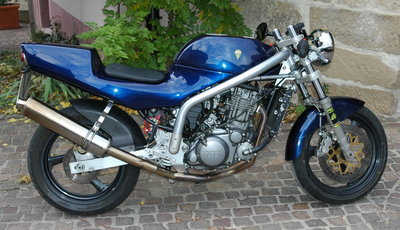

My "blue" motor was quite similar in setup:
some porting,
JE 102 piston
Megacycle 280/2 cam with stock springs
Carillo and lightened crank - but not my lighten freewheel thing which I had not yet started with.

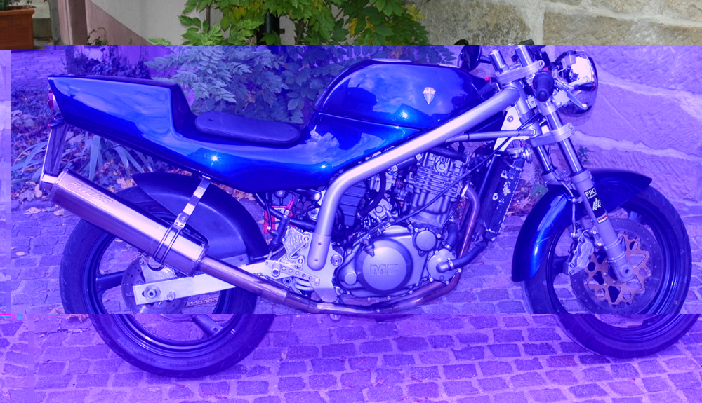

TM42 carb on Bikeworx manifold with big K&N:
my first attempt at a better exhaust system:
I was still using the stock DENSO box, the reason for the sudden drop beyond 7000 with that 7200 limiter.
But most things being quite similar, the gain of over 10hp must be mostly due to the exhaust system, some of course to the cam.
You can see that at 4500 I have about the same hp as Harold at the RPM but his stops there.
The red line is with the Stock L&W muffler. The other with a BOS (for a KAWA 750) with DB eater. The photo shows it with a BSM which, while pretty is not at all good as a can.
the point I want to emphasize is the importance of the exhaust system which too many around here seem to shrug off. Apart for the all important chassis tuning as the very first thing, the exhaust is the next thing to tackle, long before any bigger is better tuning stuff.
10hp difference is not nuttin.

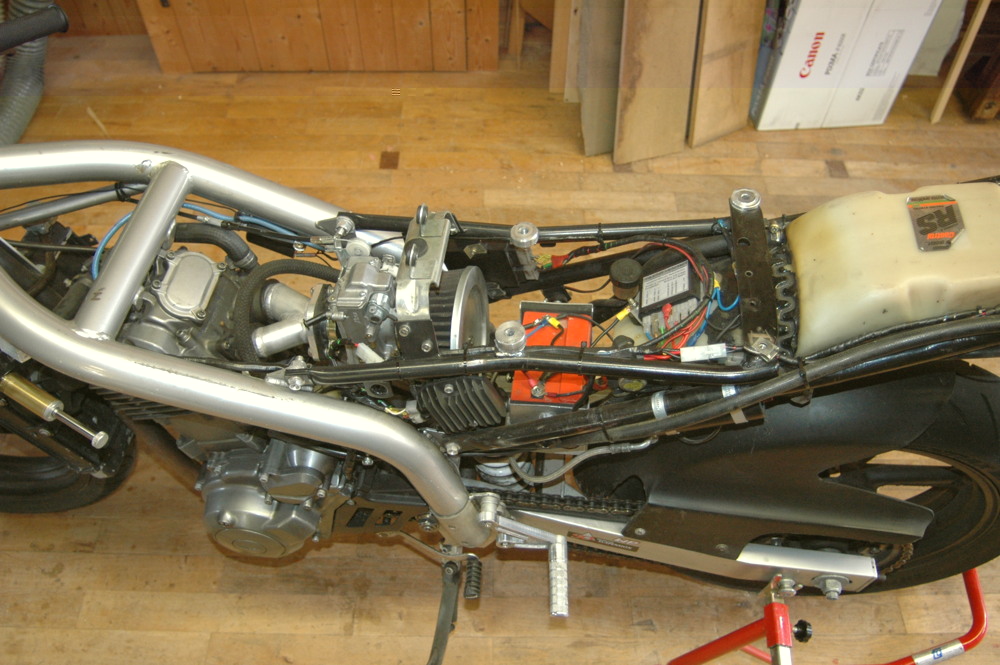

for a starter, Tim Barker offers (ed?) a 5mm longer conrod which also utilizes the the 3mm smaller wristpin from the XT550 and is thus lighter. With the appropriate spacer under the cylinder you can adjust for this as well as for pistons with other compression heights. This is normal engine building practice.
Problem with the Skorpion (can't say for a Baggi) is the engine mount at the top. For 1 or 2mm no problem really; the holes in the frame can be elongated that much.
Maybe not for the faint of heart, I removed the cross tube entirely - check my blog - with no repercussions to date.
With that gone, there is nothing in the way and - even better - you can work on the motor topend and cylinder without yanking or even tilting it.
I use a "wrong" flat top piston and adjust with a 1.5mm base gasket.
a future plan of mine would have Tim's conrod in a crank with 10mm less stroke, leaving engine height pretty much the same.
My SZR, the bike I normally ride does not have the problem since the top mount is bolted in and can be modified to suit.
