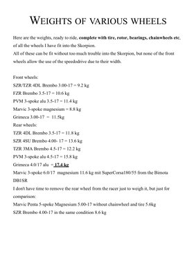

It should actually be well known that I have done the swap several times, as often as I have written on the topic.
where so you think I got this data? Made it up?

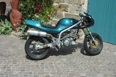

For street use, I have fit the Brembo wheels from the SZR (3.00 & 4.00)
http://home.arcor.de/w.jurgenson/pdfs/Distanzhuelsen.CAD%20(Brembo%20spacers).pdf
several times and twice TZR (3.00 & 3.50)
I use this set on the road myself with a 130/70 rear tire, just like the original Skorpion prototypes did.

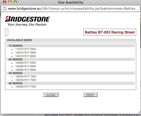

At the moment, the only racing tire they offer is the Power one which is available in 150 as treaded (sculpté) tire (only 17"), slick and rain tire (only 16,5") for which at least the 4,5" rim would be necessary. I have no experience with this tire myself, since it is new. I found the SuperCorsa SC (front SC2 at 1,9AT,rear SC1 at 1,7AT) to be as good as I would ever need in a treaded tire. The 150 Pirelli is actually only 143mm wide so it can be used in a pinch on the 4" rim; Pirelli's reference rim is 4,25".

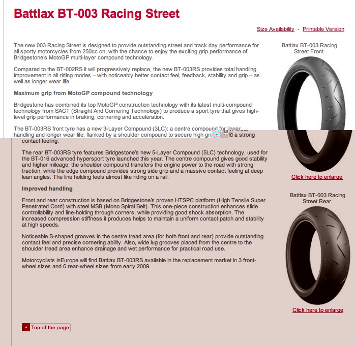

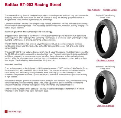

As mentioned above, I used Bridgestone slicks. Today I would at least try the BT003 racing:
There is even a 140 version of this tire which fits ideally on the 4" Brembo rim.

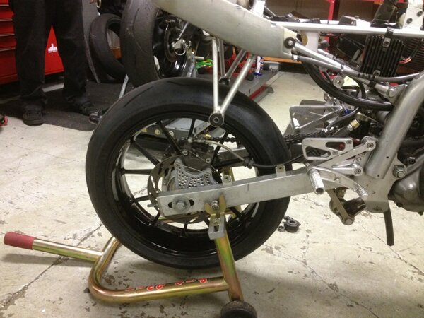

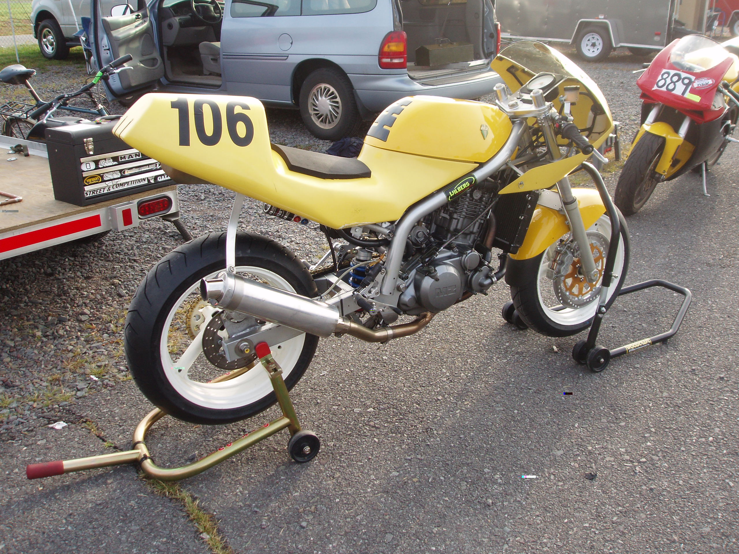

Postby morbidelli17 » Fri Jan 13, 2012 2:15 am
A friend just did that swap on his Skorp. Says the 690 wheel is about a pound lighter than the 640 wheel. Tricky spacer work, but it looks nice.

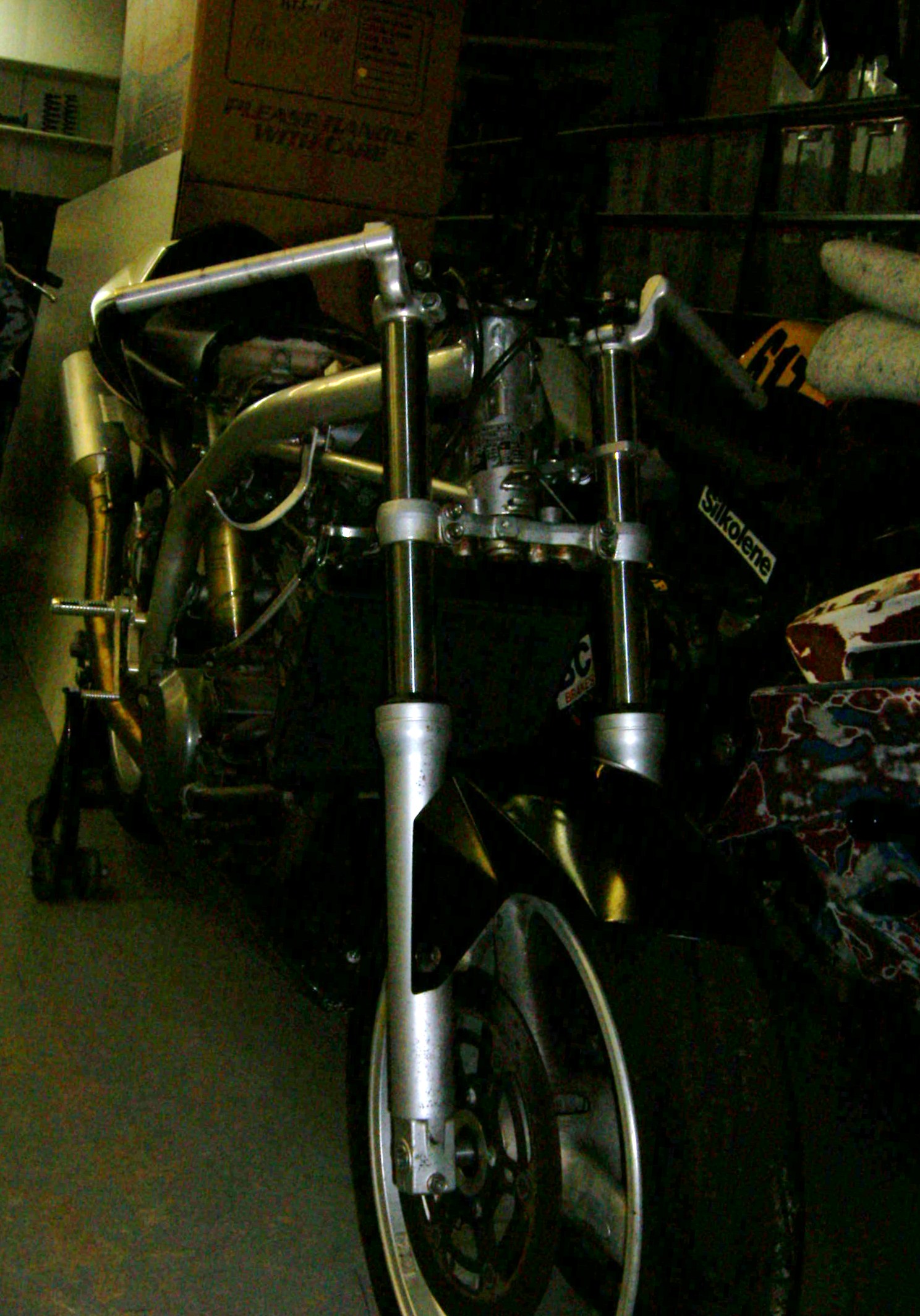

Postby morbidelli17 » Fri Jan 13, 2012 2:26 am
I just got the SV front end onto mine.

Postby basser23 » Fri Jan 13, 2012 12:31 pm
M , looks great, how much of a bear is it? Ever figure out the rear wheel swap
basser23
Posts: 654
Location: central florida
Re: Truth or BS? Rear Wheel Swap
Postby morbidelli17 » Fri Jan 13, 2012 12:41 pm
I'm told the SV front end installation wasn't too difficult. My guy machined the steering stem to fit the bearings, shortened it and cut new threads into the top. After that, obviously, everything else bolted right in. Understand that I went this route because I had a straight, newly reconditioned SV front end with Traxxion Dynamics damper rods and Gold Valve emulators and ti bolts just sitting in the garage, along with two SV front wheels of the same color. The goal is to get a lighter, wider front wheel for racing rubber, and hopefully that will also offset the additional weight of an extra (but smaller) rotor and caliper. The other advantage is in parts availability; instead of looking for MZ parts, I can just use SV stuff.
Rear wheel looks like we'll be trying spacer/sleeves to adapt the SV wheel to the smaller MZ axle. Will keep you posted.
