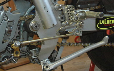

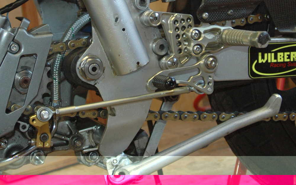

So does my Skorpion XP with the Gilles rearsets but there, it is only to be able to show the Gilles as a complete unit as they can be bought.
You can see, tho, that those are high-priced no-slop ball joints; the shift lever has 2(!) ball bearings and both it and the accompanying lever on the trans shaft as well as the toe piece on the lever have several holes to vary the actual lever travel and I have the alternative rolling toe pice mounted. Yes, I know, the Gilles are very expensive. It's like with most everything else: you get what you pay for.
