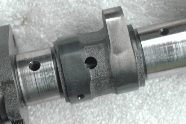

Re: deco, it is really very simple, so simple the manual need not go into it. Just put it back together as it was. Inside the cam, there is a slender secondary cam with actuates the small plunger in the lob of the left exhaust valve.
This is the hole for it.This cam has been modified for use without the deco. The weights on the cam sprocket turn that slender shaft as RPM pick up, just like an oldfashioned distributor. At rest and up to about 600RPM the plunger protrudes, thus not allowing the exhaust valve to close, above the ±700RPM the weights swing out, turning the shaft and allowing the plunger to retract and the valve to close. It is that simple. No voodoo, no gimmick mechanics like on the XT, SR and SRX to couple the deco to the kickstarter, no hand trigger and no need for it. Drawbacks? For a civilized street engine few. It can break and has. You cannot check the compression. Given that the engine is nearly indestructible, no need to for a street engine, either. For more extensive tuning, tho, it is a good idea to remove it and some racing cams have no provision for it.

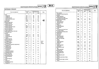

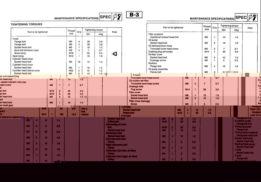

So, that ain't no marks for it, cause there ain't nothin to set. You can only bolt on the timing gear two ways, the right way and - 180º off - the wrong way. There is nothing in between. Use a GOOD torque wrench for the those M7 bolts and be careful of them.
