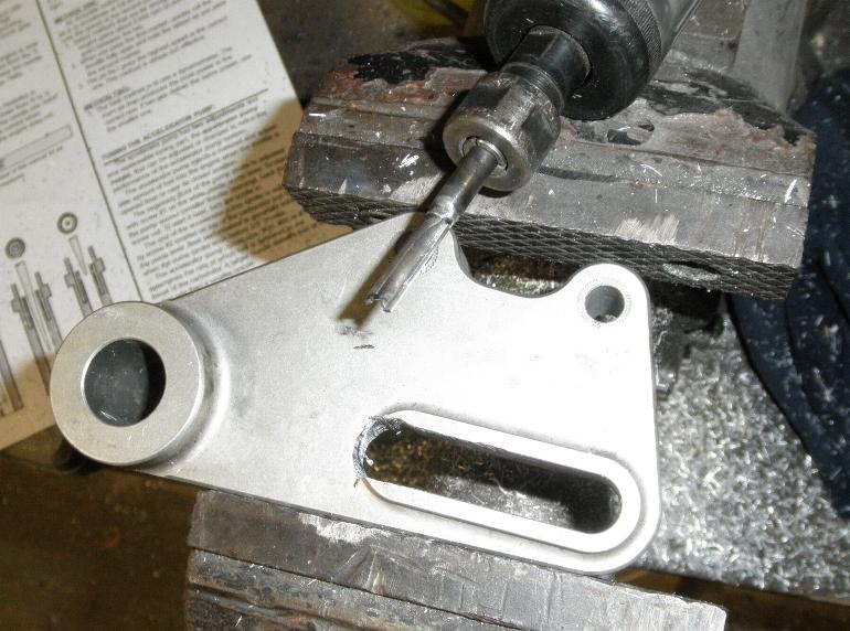

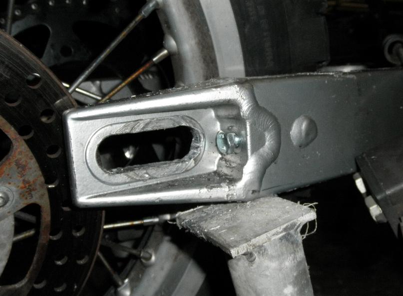

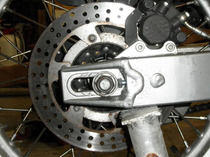

1st off I saw the adjusting bolts and nuts for the axle were stopping the axle from going forward the 1/8" I needed. So off with the nuts. Then it was the rear caliper slot, so it was milled forward some. Then it was the swing arm itself, so it was milled forward some. Finally, it worked. However, my first test ride gave me the distinct feeling I had wasted a day. No perceivable difference, from either the 45 to 47, or the 1/2" less wheel base.[/attachment]brake mount.jpg
Final results, and shorter wheelbase
swing arm milled
caliper mod and die grinder
