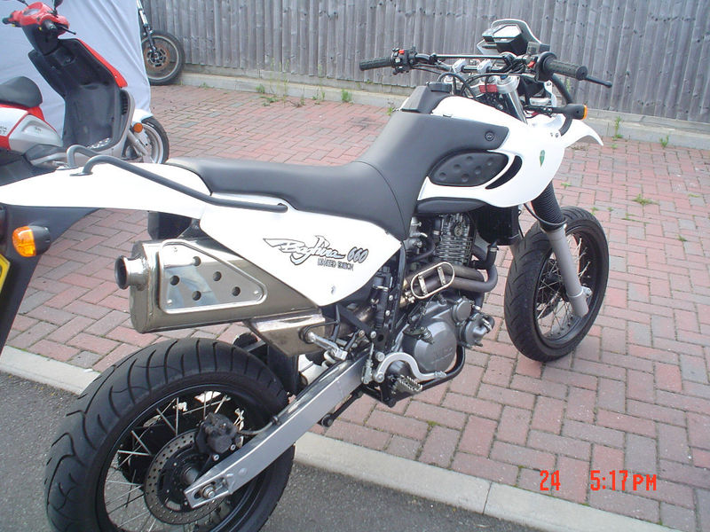

Hi all, after trawling through this great site I still can't find a definitive answer to what is a direct replacement for a Baghira rear disc/rotor, I have an 03 baghira black (white!) panther and need a rear disc and brake hose. I can get the hose made but just do not know which disc to purchase so any help would be greatly appreciated. Also is it normal for the forks to dive so much even under soft braking? Many thanks for any help/advice you may be able to give.
Added a picture of my pride and joy!
