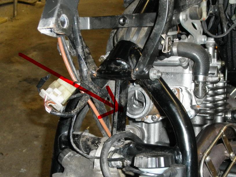

The Baghira has a frame that not only makes it hard getting the stock carbs off, but prevents you putting a single carb on, since it has a vertical 1/4" by 1" flat stock steel member running right down the middle of the frame.

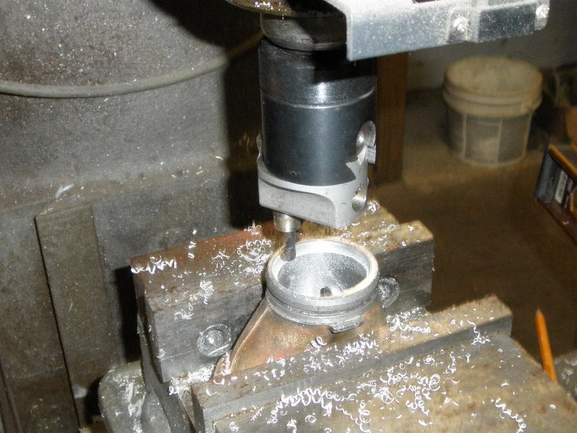

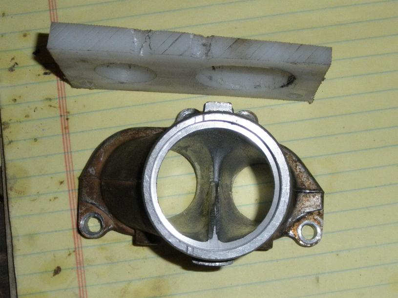

I cut it out, made a manifold to go from the Grizzly port spacing to the Raptor port spacing, and found there still wasn't room to get the Mikuni on without putting it on the other side of the frame. This requires a 5" of so spacing between the carb and the Grizzly manifold. It also required a beveled spacer to get the carb level, and beveled both ways. To make a leak free connection required milling the input of the Grizzly manifold to accept a 2" aluminum tube. with it also turned down. A 2" plumbing rubber union hooked it all together, but the gas vapors only go through the aluminum pipe.
Strut
Milling the Grizzly manifold
Milled manifold and double beveled spacer

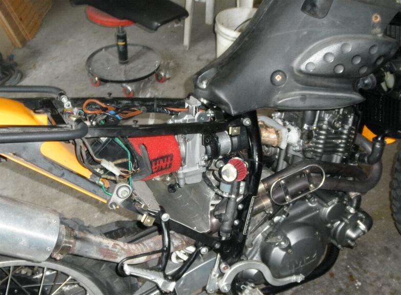

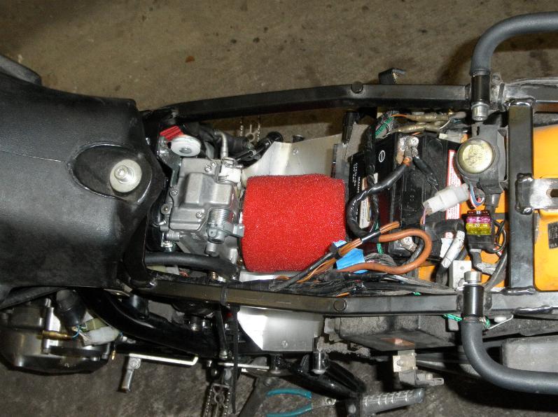

Here is a picture of the final installation. I put a K&N filter on the crankcase breather tube that used to go to the airbox.
Top view
