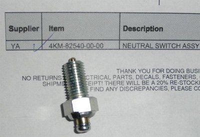

I had found this part number on one post while searching, and then for whatever reason could not locate it again. This one fits a 2002 Baghira, and probably all 660 MZ's, but look at the picture and decide for yourself if it is the same as yours.
Yamaha part # for neutral switch

Postby Bill Jurgenson » Tue Aug 23, 2011 1:33 am
4KM-82540-00-00
according to the online part list from Yamaha.

Bill,
I posted this more for us in the US, who can not find a XTZ listed since they weren't sold here. Local shops, and online part sellers don't list them. The Raptor uses a different switch, but the Grizzly uses this one, along with about 100 other Yamahas. I almost ordered the wrong one, and thought maybe this could keep someone else from making the same mistake.

Postby Bill Jurgenson » Wed Aug 24, 2011 2:32 pm
the online partslist is at Yamaha US. Over here there is no counterpart, unfortunately.
For the entire bottom end except the right side cover go to 1993 XT600E
and for top end parts the Raptor 660.
