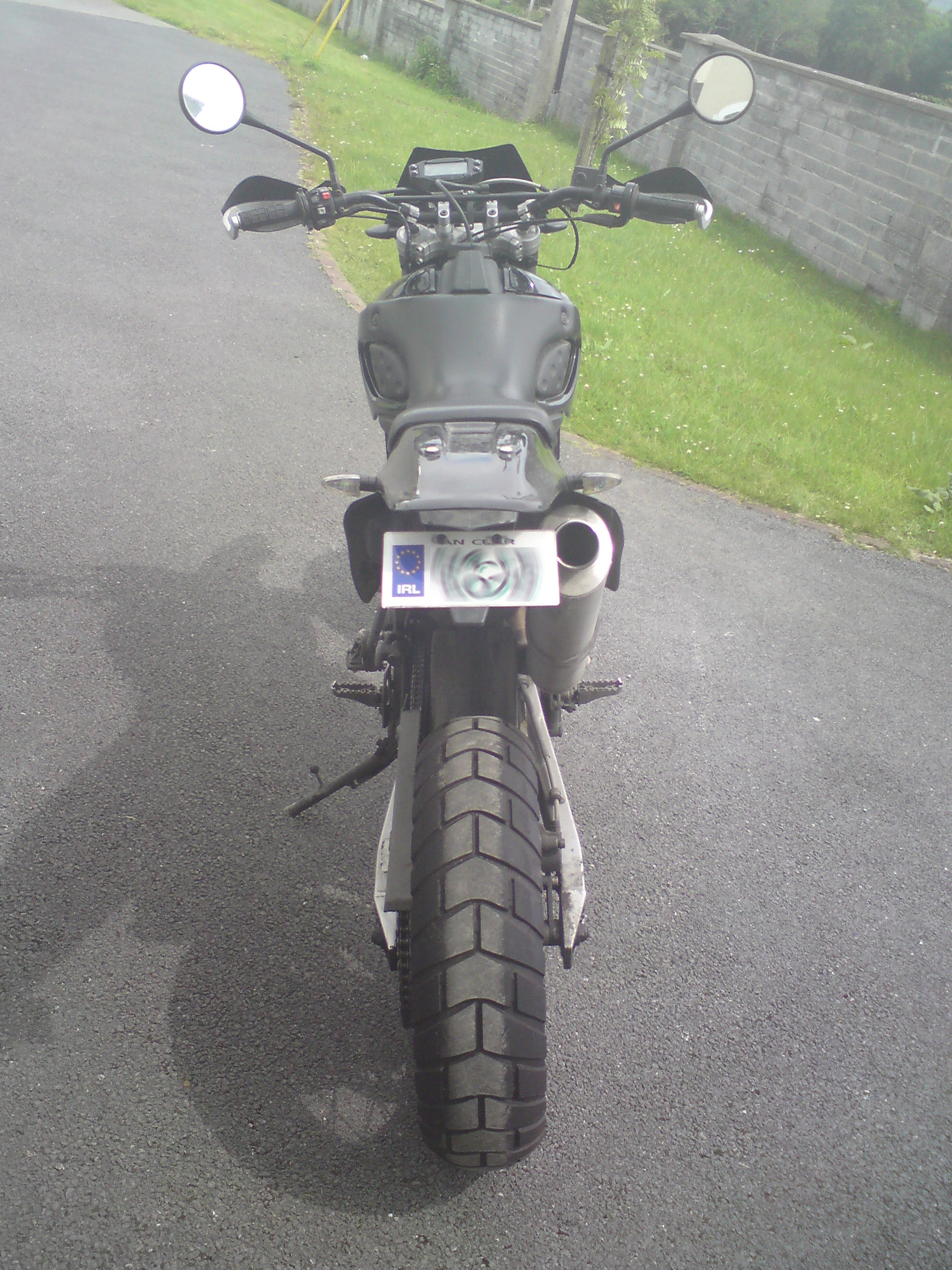

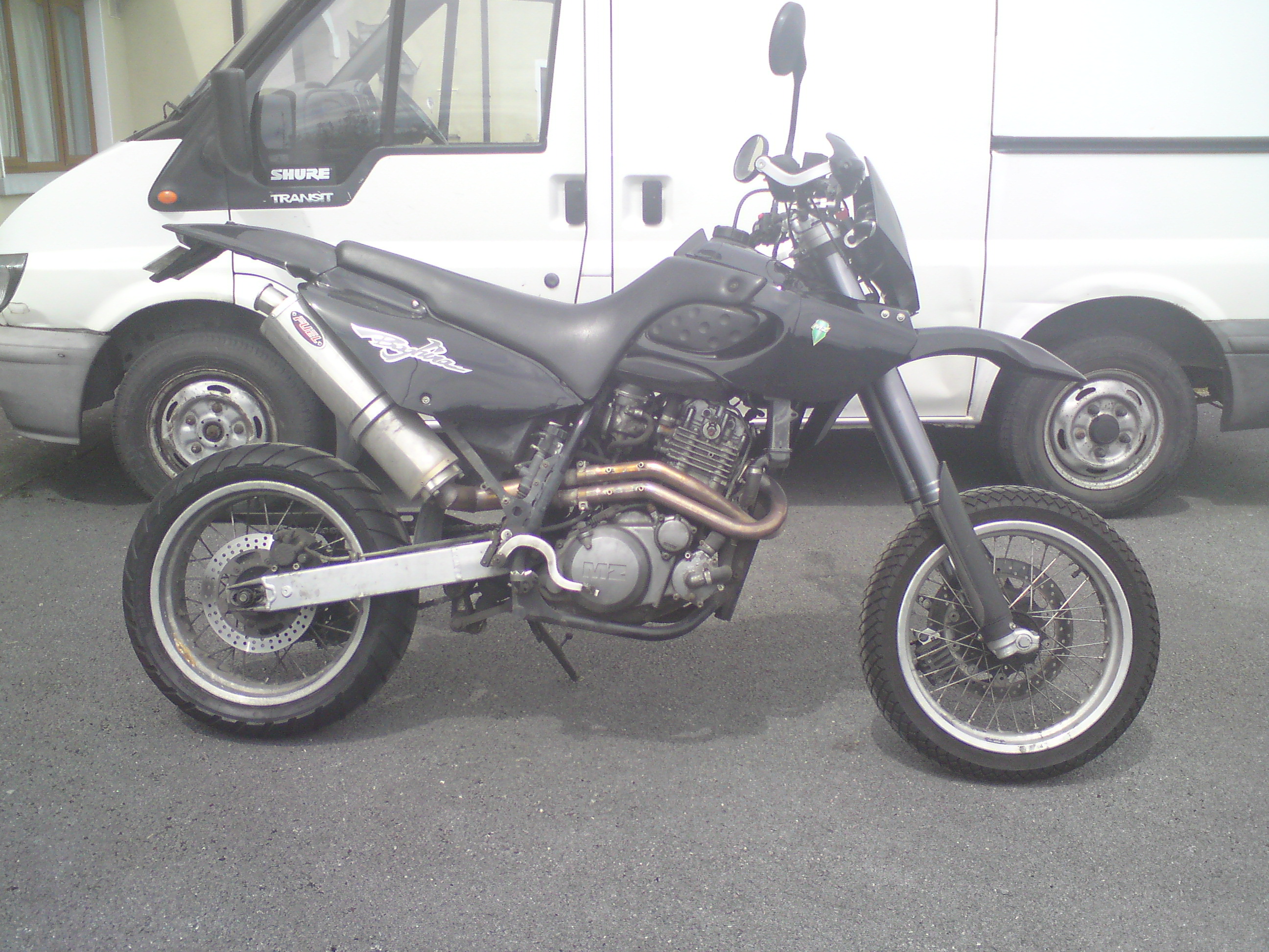

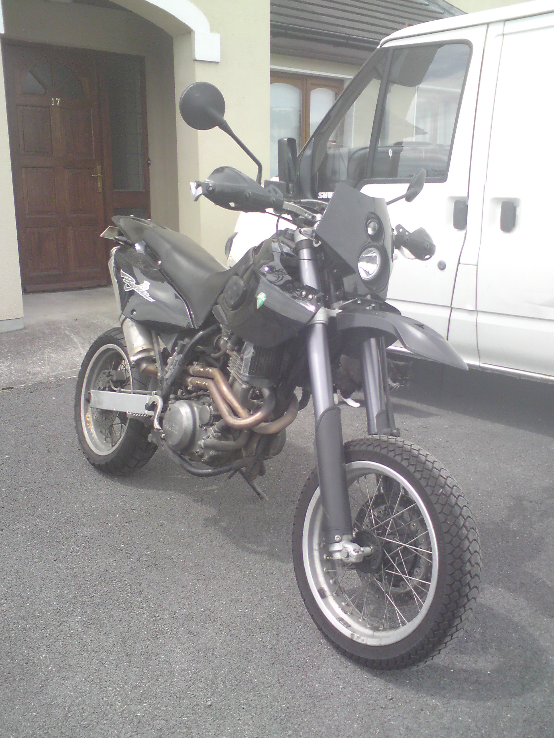

Pics of the bike. Any comments or tips on the next mods to make are welcome.

Very nice looking bike, especially the lights. Will it power wheelie 2nd?

harold wrote:Very nice looking bike, especially the lights. Will it power wheelie 2nd?
Ha,ha! I'm the worlds worst stuntman. If I shut the throttle, then whack it open in second, yeah, the front comes up, but I bottle it at a couple of inches. If I do the same in first, it's too viscious. My fingers seem to be too short to tickle the clutch lever so my next mod'll be levers. I had it dynoed and it read 44bhp at the wheel.
