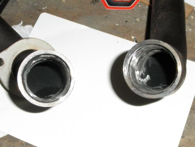

Then I ground down the welds on the header pipes. I have heard on a Honda XR650 forum than this didn't make any noticeable difference on a stock motor, but I had them off to make life easier on the carbs, and was able after about 15 minutes to get the same size socket to go in the inlet as went in the other end with no welds. One size smaller socket wouldn't go in when I started. I also ground off the weld splatter. I have heard of people using a dremel and going through many stones. I used an air die grinder, and only used one cheap stone from a parts store.

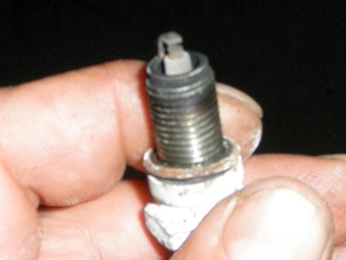

In short, it has more power, how much only a real dyno would tell. What made the difference? Well I changed way too many things at once to tell. My plug does show it was running a little lean before I think. But my fans have kicked on for the 1st time after wringing it's neck, and it is cooler today then the last time I rode it. I could have kinked a hose a little and need to check that. Whoever designed where oil hoses, wire loams, and radiator hoses all end up at the carbs, should be shot. If I ever tear into this thing again, I am buying longer hoses and moving stuff out of the way. In the next week or so I will play around with right carbs adjustment screw I changed, just to see if that makes a difference in snap. Those adjustments are easy.

Here is a picture of the plug, and headers.
