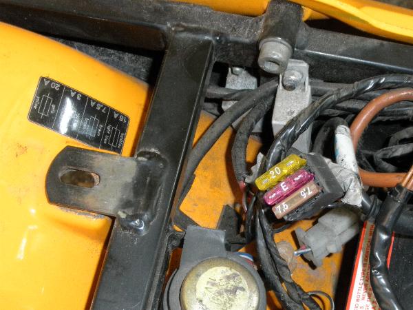

Having just got this bike, 2002 Baghira a couple of weeks ago, this forum has been tremendously helpful. I noticed when I bought the bike, that the fuse block only had 3 fuses, even though on the side you can see where it lists 4 fuses, as does the parts diagrams I have seen. The fuse block looks untouched, but the previous owner said when they bought the bike several wires were disconnected in this area, so the fuse block may not be stock. It wouldn't bother be so much except the neutral light doesn't work. I have checked the bulb and it is OK, so I am wondering if there is another wire that should go to the 4th fuse that isn't, and that's why my neutral light doesn't work. I appear to be missing my 15 amp circuit.
Cam someone tell me:
1. What fuse the neutral light runs off of. I found out the hard way that the 3 amp fuse in the middle does the turn indicators.
2. Should the heat light come on with the key, like most warning lights, to let you know the bulb is good? I have checked it, and the bulb works, but it never comes on. The bike doesn't run hot, but it would be nice to know that the warning light worked if it ever did overheat.

Looking at my baghira wiring diagram i have four fuses. 3amp,7amp, 15 amp and 20amp fuse. One of the fuses the 7amp supplies power directly to the thermo switch which controls the engine fans and also the warning light. Coming off the fuse block the wire is listed as sw 0.75.. Don't know what color sw is... Sorry I don,t know the color of the wire right now but will take a look at it sat morning and get back to you... My fans come on after idleing in the garage about 5 minutes on a 90 degree day... temp light has never come on ...I should check the bulb probably just to be safe

Can't speak for the Baggi but the Skorpion also has the 3 fuse holder. The fuse for the fans and thermo switches and is separate, in line.

Thanks for the replies. With the wiring diagram I will try to trace some things.
But can someone tell me, does your heat light come on with the key, like a normal warning light? And, even in FL, my fans so far have never come on that I have seen. The bike also has never acted like it was over heating. After a 15 minute ride at 95 degrees, when I turned it off, I could put my hand on the radiator cap. BY the way, when you try to next put your hand on a radiator hose, with bifoculs and a semi dark garage, your black exhaust pipe looks a lot like a hose. Until you touch it of course.

Thanks guys. It is nice to know about the heat warning light. Since the wiring on this bike has been messed with, I didn't know what I should expect. I will jumper the fans to make sure they work. The neutral light is something that I can do without, but I am hoping to find a wire that they just didn't connect right. These diagrams will help. The PO disconnected the side stand switch, and just twisted the wires together. That is where I think I'll start looking.
