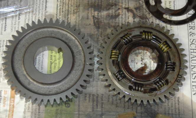

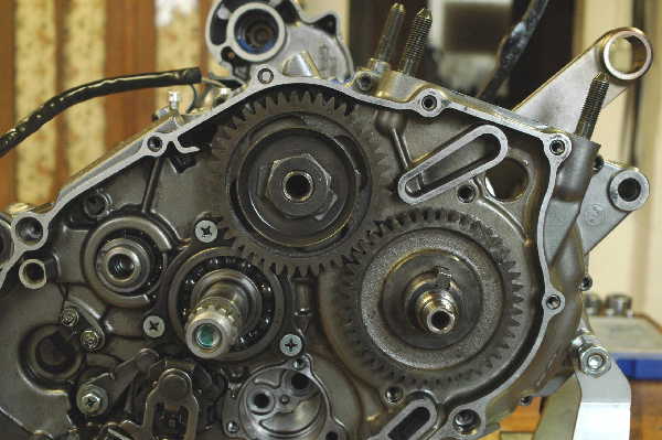

Postby Bill Jurgenson » Thu Mar 22, 2012 2:01 am
Raptor 700 has a solid gear. That is the gear in the photo.
I prefer the Raptor gear myself.

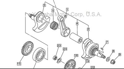

the parts numbers I posted are Yamaha parts numbers; here again:
balancer gear Raptor 1S3-11536-00
Balancer gear XT660R 5VK-E1536-00
The XT660R is not marketed in the US, so parts for that could be a problem.
any idiot can see that the code for that part as such, (i.e. the gear driving the balancer shaft) is 1536, prefixes are model idents.
If the so-called dealer can't get a part for a quad sold in the US, he doesn't know his ass from a hole in the ground and does not deserve even the time of day, let alone business. Shun.
screenshots from the US online parts catalogue page for the Raptor 700 crankshaft:
number 15 in the shot

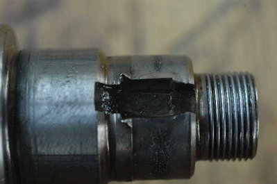

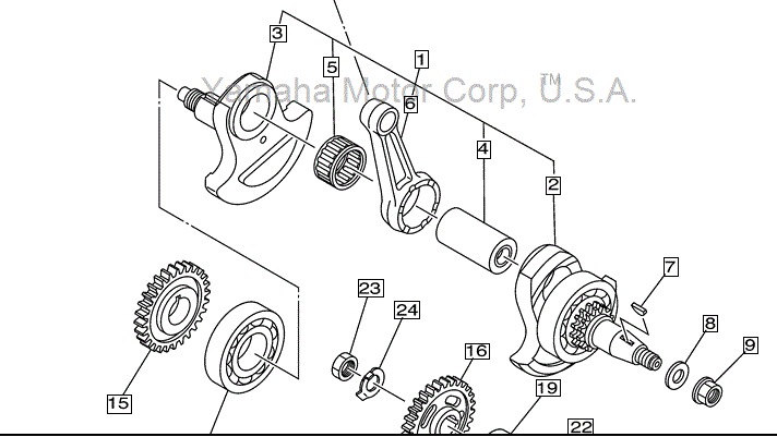

BTW, the clunk noise is almost certianly the balancer bear and woodruff key in the crank.
besides the gear, you need to order the lockwasher and key. These are standard parts that fit almost all Yamaha singles starting with the xt600 thru all the various SRXs, XTZs, Grizzlies, Raptors
