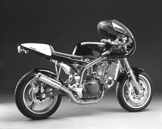

Just trying to find out if there will be interest from you guys in MZ Skorpion race seat?
After talking to my brother, he said that if he can get at least 5 orders then they (Motoforza) might be able to borow the seat from Kehrers and make a mold.
I was even thinking of ordering 5 seats myself and then put them out for sale but need to know if there will be interest!
Here is how the seat looks like. Let me know if anyone will be interested.

Will I be able to make it fit over the stock oil and coolant reservoirs after hacking away at my sub frame or are we talking major bike mods to get this to work?
Re: Feeler for Skorpion race seat
Postby basser23 » Fri Jul 15, 2011 3:03 pm
Me,Me Me.....good point as to fit on stock subframe with oil and overflow tanks...

edfmaniac wrote:Will I be able to make it fit over the stock oil and coolant reservoirs after hacking away at my sub frame or are we talking major bike mods to get this to work?
I think this should fit right over the tank, using the stock subframe. Minor mods maybe but nothing crazy, if any at all.
Maybe if Bill Jurgenson gets here he might be able to answer this better as I think he seen the Kehrers bikes :D

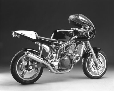

Postby edfmaniac » Fri Jul 15, 2011 10:32 pm
This is what I really want. I'd even go through the trouble to build a new oil tank if I could find a seat that is this compact and clean looking. Anyone have a clue who makes it, assuming it can still be found?

Postby Bill Jurgenson » Sat Jul 16, 2011 2:11 am
probably, no, certianly involves major surgery. Kehrer's Works racers are those of the second group from MZ. Look very closely at the frame.
It only looks like what you have but is quite different. Look where the swingarm axle is or at the welded front cage around the engine. Needless to say that the rear subframe is minimalistic. And there is no oil tank; the frame is the oil tank.
Both Beasley in the US and MLB here in Germany make (made?) readily obtainable one-piece seat GF cowls that fit the stock seat frame. Google pictures of our own Chris Hunsicker's racer (since sold); it has a Beasley seat.

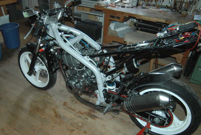

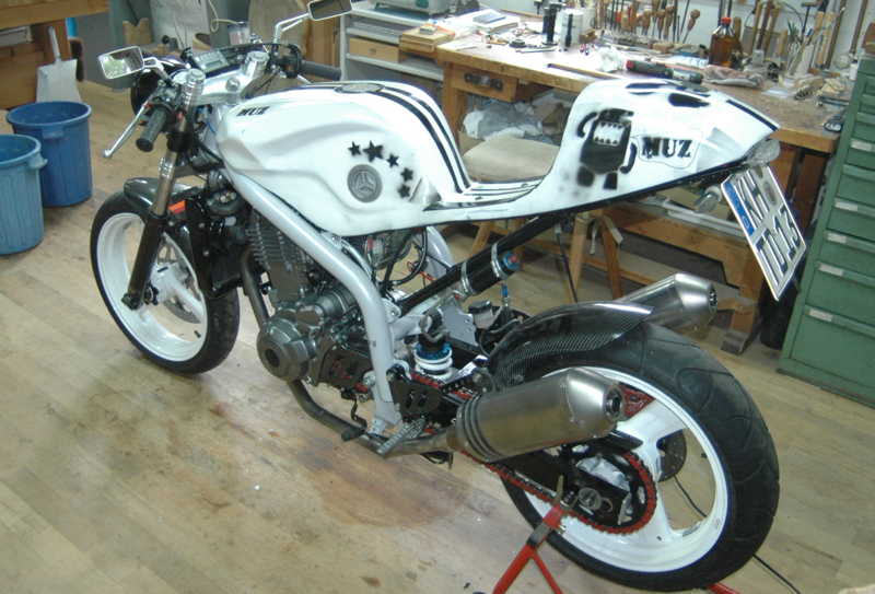

A member (Carlo) of the German Skorpion Forum is making CF look-alike parts for the Skorpion. These include front and rear fenders and even a cog cover. I recently had a customer's bike here with these items on it and the fenders looked good. If I remember right, Carlo also made, or was in the process, a RS125type seat and at one tank/seat monocoque. so, unless these were done with styrofoam lost form method, there is a form and possibly more to be had.
And dutch fellow has just yesterday presented a CF tank for the Skorpion, on recessed on the bottom for better conditions for flatslides etc.
You have to register as in any forum, but English is no real problem. several non-Germans write in English.
here pics of that customer's bike where you can sort see the fenders:

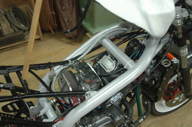

This one is also oil-in-frame like two or three more in our forum here:
you can see the return line going to the front of the frame and the feed line at the bottom. Both cross tubes have been drilled from outside and the the holes welded shut again. The frame contains about 3 liters. I am not a fan of this modification and am not advocating it, not with the stock frame.
