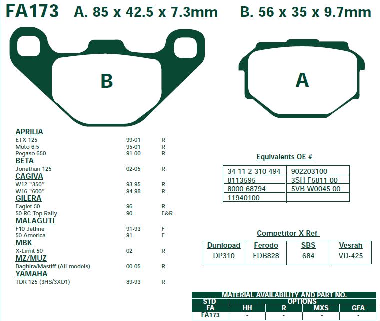

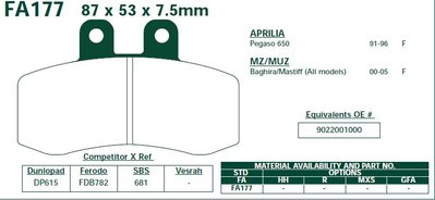

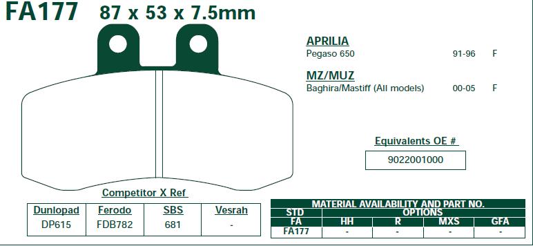

the ebc book info
and read this link
being there rare he may have some
viewtopic.php?f=18&t=4260
click on the picture for big view
Re: Brake Pad Source in US?
Postby kman.45 » Sat Jul 16, 2011 7:20 am
hasn't been that long since I got EBC pads from cyclebrakes.com. Even if they don't show on the website, call and order FA173 and FA177..
