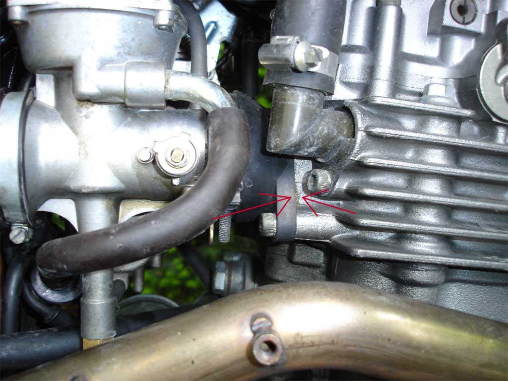

on a german website i found this picture, to remove the reduction you have to take the carburetor out, remove the right rubber connection between carburetor and head, between the rubber and the cylinder is the restriction. should be a thin metal plate that restricts the airflow into the cylinder. i hope i did not confuse you!, michael
between the red arrows is the restriction
