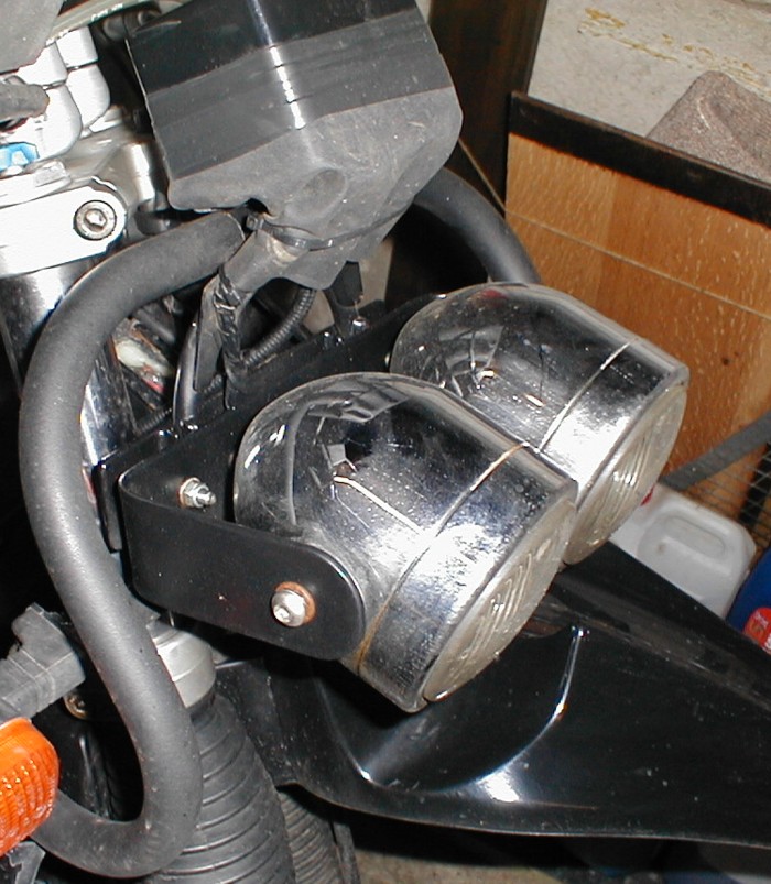

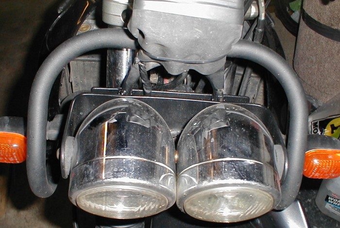

I fitted the streetfighter style twin headlights to my baggy
similar to Item number: 8065747124 on ebay.co.uk
they arn't the best out there but have lasted for 4yrs so far. . .

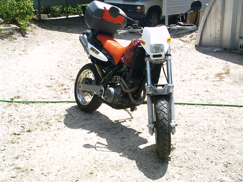

I replaced my headlights with a aftermarket dual sport unit. Has 55w with good reflector and even had a parking light!

BRAAAP ! How did you fit the streetfighter lights?

Postby BRAAAP ! » Tue May 23, 2006 10:51 am
I got some 3mm plate, bent it into a C shape to form a bracket to hold the lamps and the bolted the whole lot to the metal work on the front.. .
I'll try and get some pictures to show you inna bit. . .

Postby BRAAAP ! » Tue May 23, 2006 1:43 pm
Here you go. . .
Please excuse the muck & rust but this is an all year bike
Can anyone suggest a "prettier" way of waterproofing the clocks other than pond liner and tape . . . :lol:
