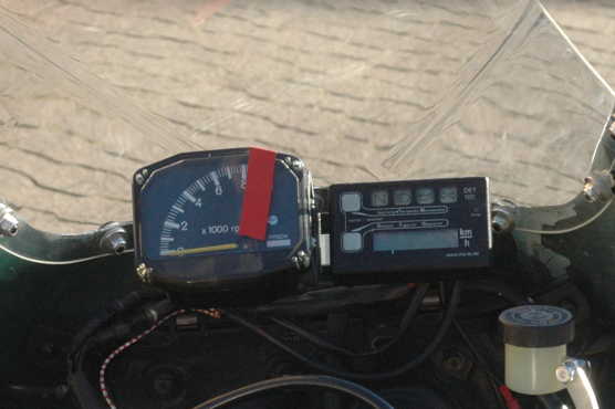

I have fit their present model electronic speedo to customer's bikes and it very good. Not cheap, it is a classic 80mmØ instrument that can be fit into the instrument holder. The page has a link at the bottom to the matching tach. One customer paired the speedo up with the tach from a Yamaha SR500 which is the same size and mechanical.They ought to be plentiful and relatively cheap and the angle drive from the cam is a plug and play Yamaha part. And of course, the SR500 speedo would fit just as well. While still employing a magneto, I used a mechanical tach (SRX) driven off the cam.
Such a combination will give the owner wanting that classic round look what h is looking for.

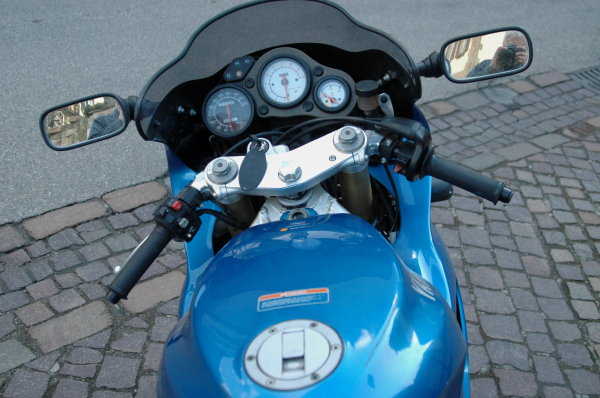

Likewise, a stock Yamaha cockpit such as that of the SZR or TZR is pretty much plug and play as well and even offers the thermometer mentioned.
Mechanical speedo connects right up; thermometer needs a different thermosensor but that would be case for any thermometer; tach needs that other DENSO box mentioned above or a Sparker. The dash of my SZR (here) has never caused the slightest trouble; my green Skorpion originally also had this dash. I later fit the speedo to a customer's Tour; the tach was sill in use on my very early version racer.
Both of my street MZs used a DET 100 instrument, the first of which I got 10 years ago (or more). While the instrument is very good, I fear for the health of the company is not as good. I have not been able to a rise out of them at all.
Here on my present Skorpion, along with the Kroeber/Pitsch tach(for decades THE reference racing instrument!) retained from the racer. This year I removed the Kroeber and sold it. the DET shows both rpm and speed and can be switched to show other data such as voltage at the moment or temperature if there is a sensor connected.
