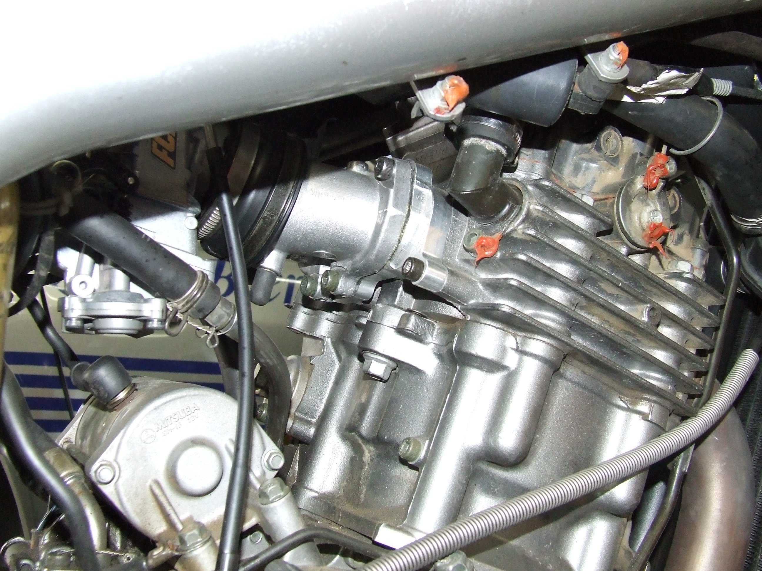

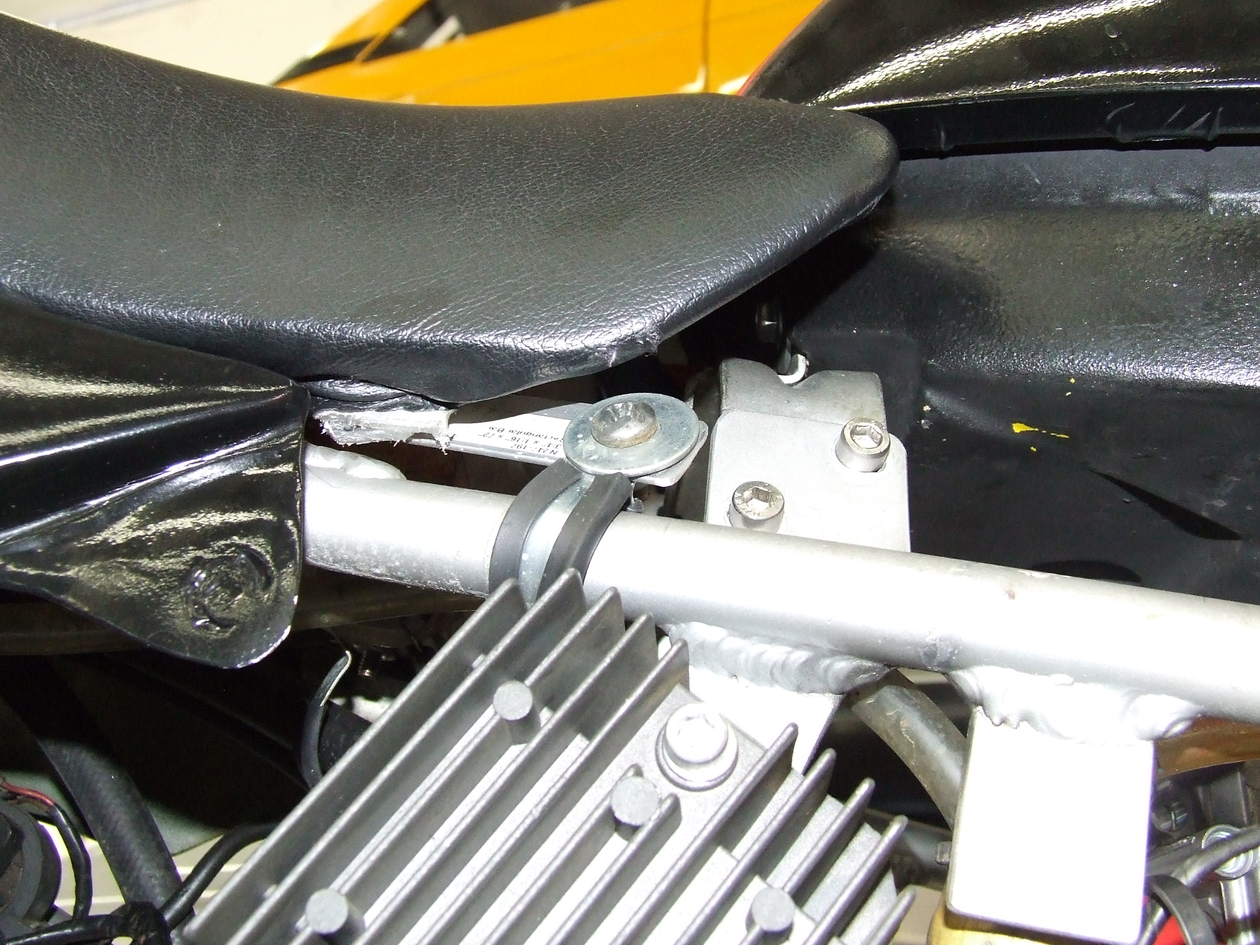

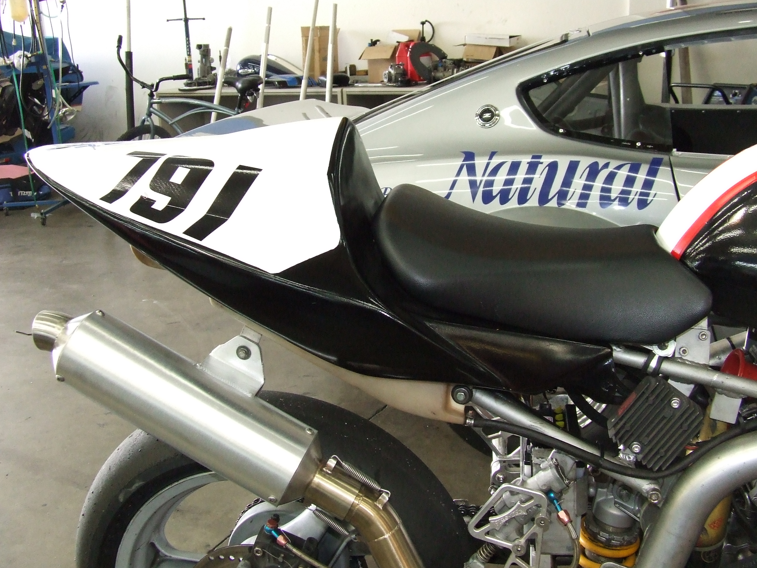

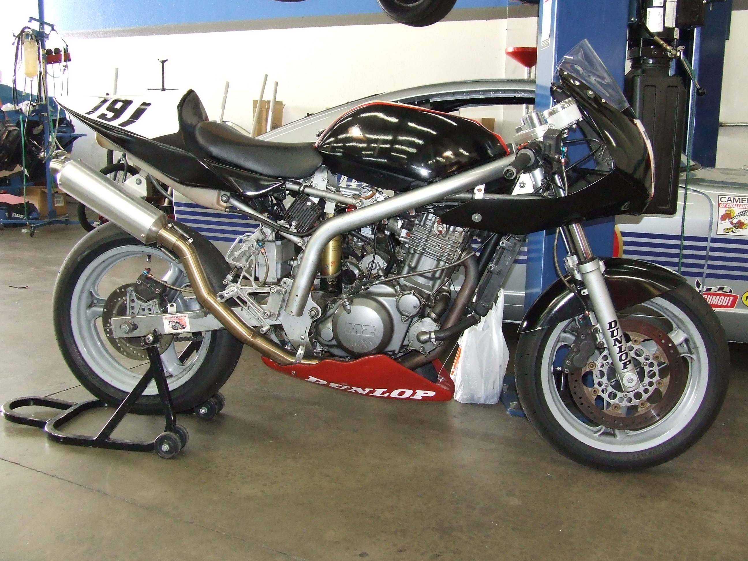

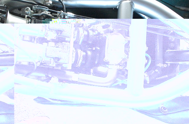

Attached are some pics of the bike. Note the mounting plate for the single 41mm Keihin FCR and the SV tail section with SV seat and baling-wire mounting hardware!

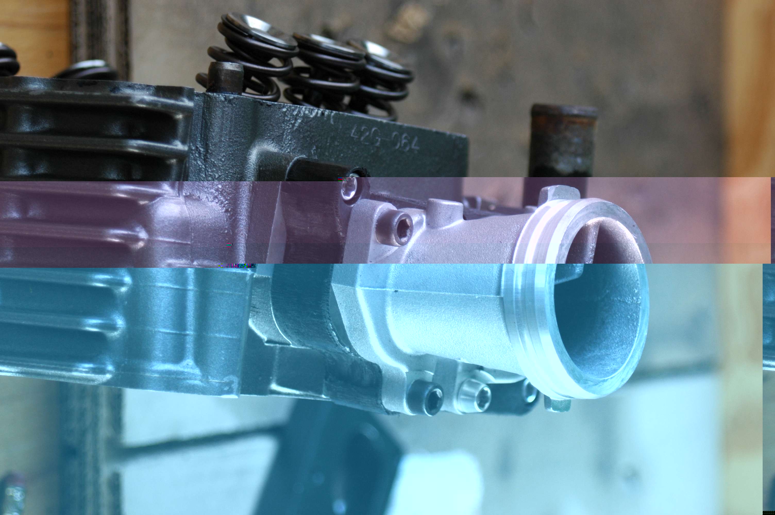

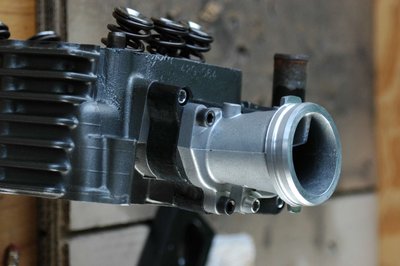

Postby morbidelli17 » Sun Nov 21, 2010 10:52 pm
CNC plate to adapt Yamaha Rhino 2-1 intake to the MZ head. Then it was just a matter of getting the correct spigot for the FCR to mate to the Rhino intake.

Postby Bill Jurgenson » Mon Nov 22, 2010 3:48 am

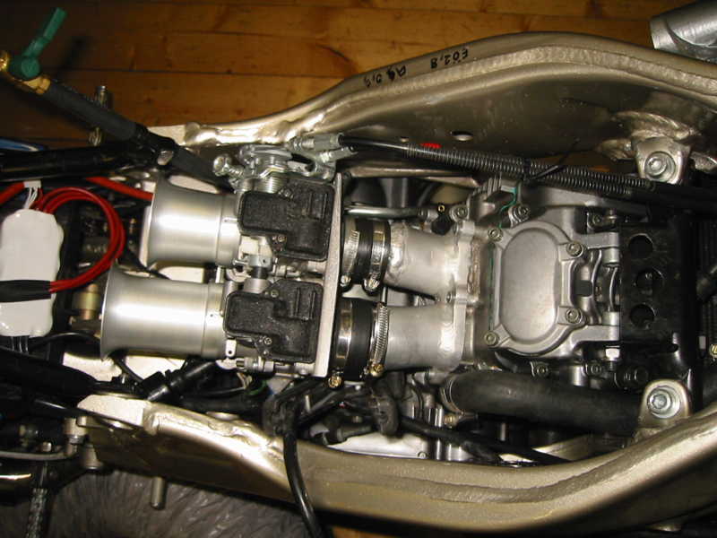

Friday, October 8, 2004 7:08 PM
yup.
Used it with a TM42-2.
Having used both, I can say that the Bikeworx manifold is much better.
It is considerably longer. Of course, one can and should make that spacer/adaptor much thicker than either you or I did. I used the Bikeworx thing extensively on the road but for racing I used dual 38mm Mikunis.

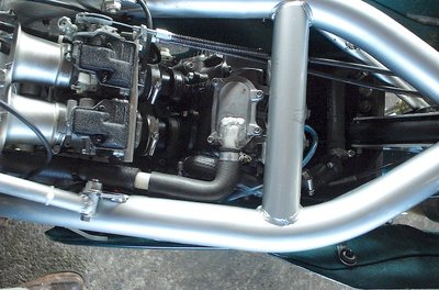

here with 2" long spacer tubes between rubber joints and carbs.
This is a Slipstream head in a friend's SZR with their welded manifold and, again, dual 38mm Mikunis.
You can see that the two branches are the same size. The head was welded closed and the two ports remilled, the connection for the middle valve opened equally to both. You should note, how long that manifold is.
