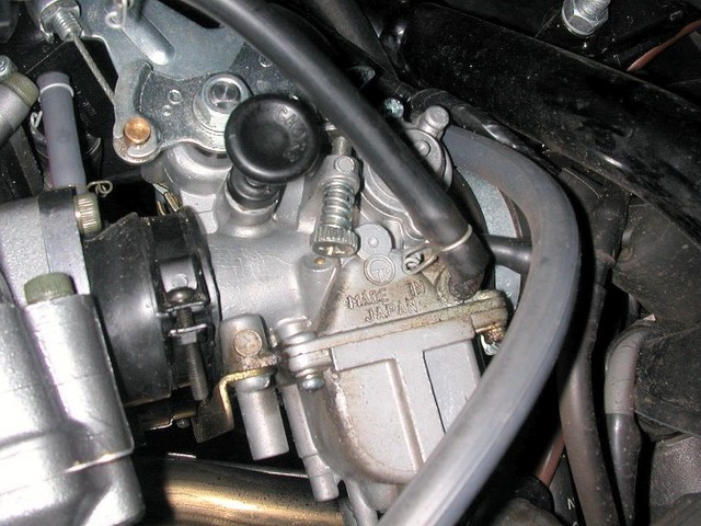

Postby nopantsflyer » Wed Nov 24, 2010 12:21 pm
puts the choke right on the carb, no more cable and no more problems with moisture
http://www.yamaha-motor.com/sport/parts/home.aspx, thats what it looks on the carb

Postby AtomicSpew » Wed Nov 24, 2010 1:20 pm
Thumbs freaking up! I love this site. Thanks much for the link and pic!
