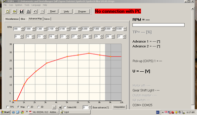

-and of course an Ignitech Sparker programmed to a max of 29º BTDC at 6000 dropping to 27º by 9000

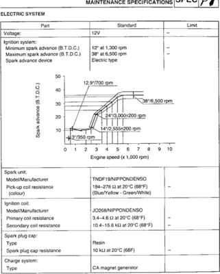

compare:
That nearly vertical advance around 3000 is the reason for the chainlash.

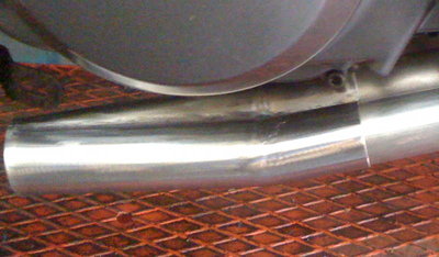

You need someone very adept at WIG welding to weld up the junction pipe with that thin wall.
I drew up a 1:1 top view and side view (orthographic projection, remember?), cut the tubes and had my professional friend weld them so that I had two of the same with that ± 15º bend welded you can see at the front end. I them made a jig from plywood to support and clamp one tube so that the long cut would be vertical to the table surface. I then cut thru that pipe with the big bandsaw using the side fence. I then reversed the supports on the jig to clamp the other tube mirrored and cut that one as well. Rolf then welded the two together along that long joint.
shown here just after welding and polishing before determining final length which was done by shortening the end until the 50mmØ equivalent crossection was attained. The bought 15º slipon junction was shortened and flattened to match both crossection and position, the meant-to-be-clamped slotted end was "relieved" of its slots and finally the hooks for the spring were welded on after the system was completely installed. they are not really necessary and there is no spring for the mating of headers and siamese. Likewise, we decided to leave off the frame connection the OEM system has, ltho I had made it ready to weld on, because both Rolf and I hunch that the OEM system cracks (VERY often!) a the welded junction of the two headers because of this fixed point.

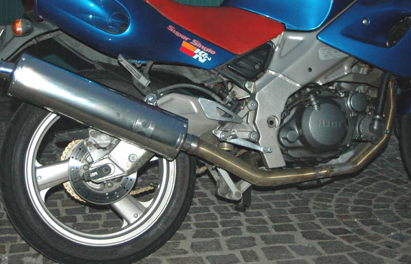

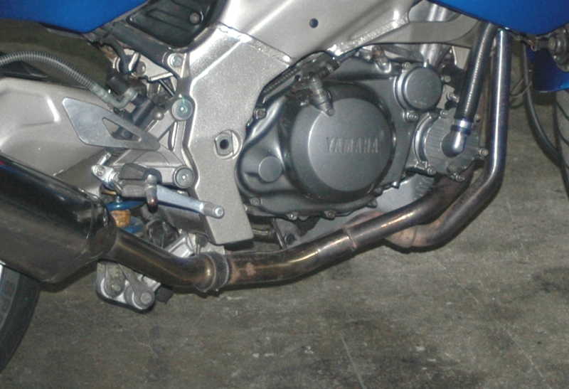

This is the original LaFranconi system. Purpose and design of the two headers is something no one really understands; the routing is terrible and there is no reason on this or any other earth to make both exactly the same length since it is only one cylinder. The skinny Ø is also obvious.
this is the Termignoni Cup system mounted on my own bike with a SR-Racing can. It, too, has 35mm OD headers, which are, however slightly larger in ID since the tubing is thinner-walled. Ther are not that many ways to skin a cat; what I made resembles this closely.
