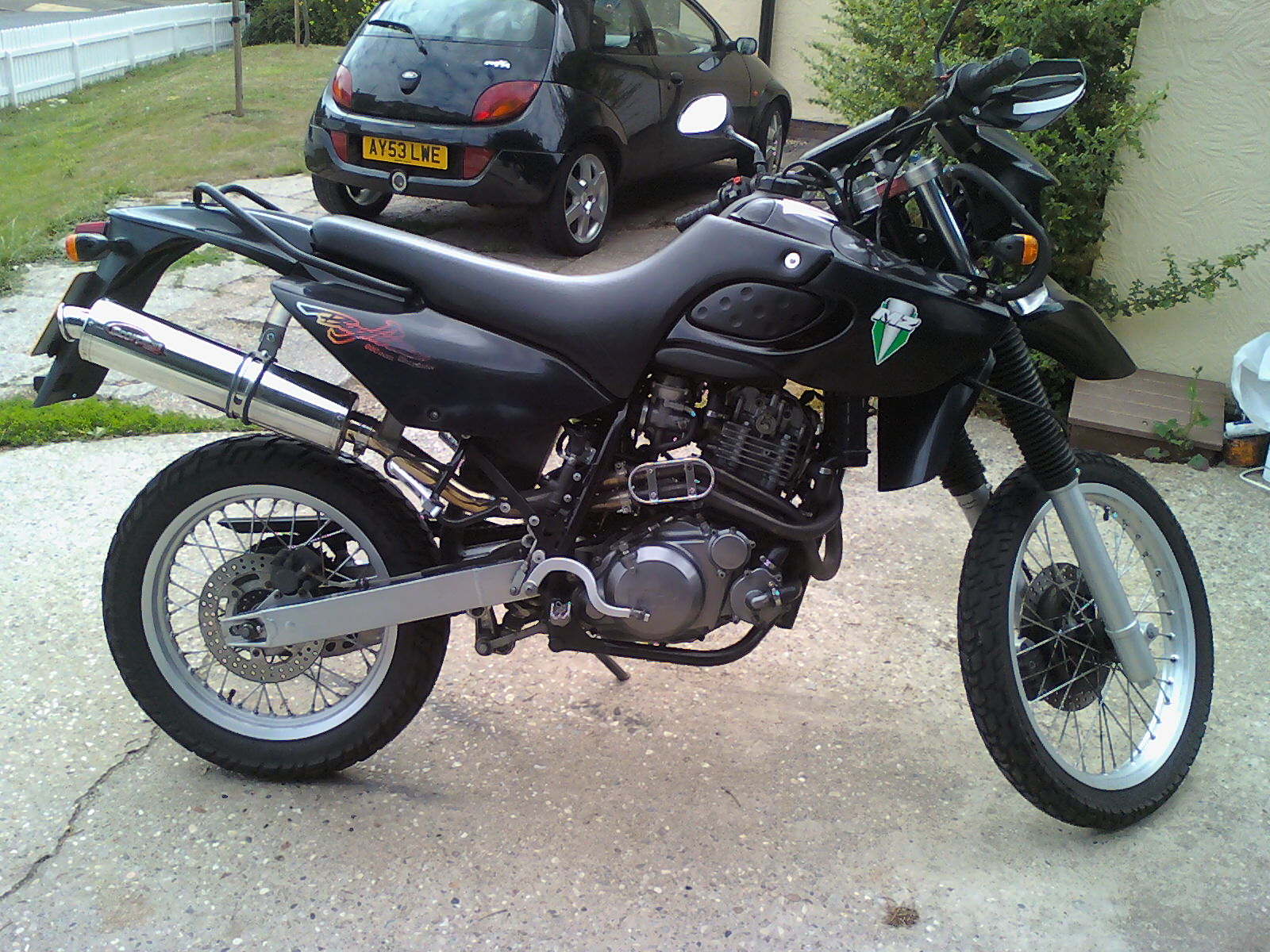

Postby Levi Nash » Thu Jul 29, 2010 7:49 am
Hi Dave,
Heres some pics of my 2001 baghira with the scorpion exhaust.

Postby breakwellmz » Fri Jul 30, 2010 3:28 am
Looks good,excellent!£60 to get that work done(Not `Mates rates`?)is a bargain,as was £50 for the endcan(it looks like new!)As you`ve not mentioned it ,i assume you did not change jetting?BIG QUESTION-Does it go any better or feel different?Cheers-Martin.

Hi Martin,
Nope not mates rates simply called up and booked in one morning then went in and got the work done. Your right havent changed the jetting. It pops a bit on decelleration but not majorly. with the baffles in theres no popping at all.
It definatly has changed the bike. Acceleration is improved, i think partly due to it being a better quality exhaust and also becuase i reckon the bikes
lost a good 10kg by doing it.
Are you thinking about having some work done to your bike like this?
Levi

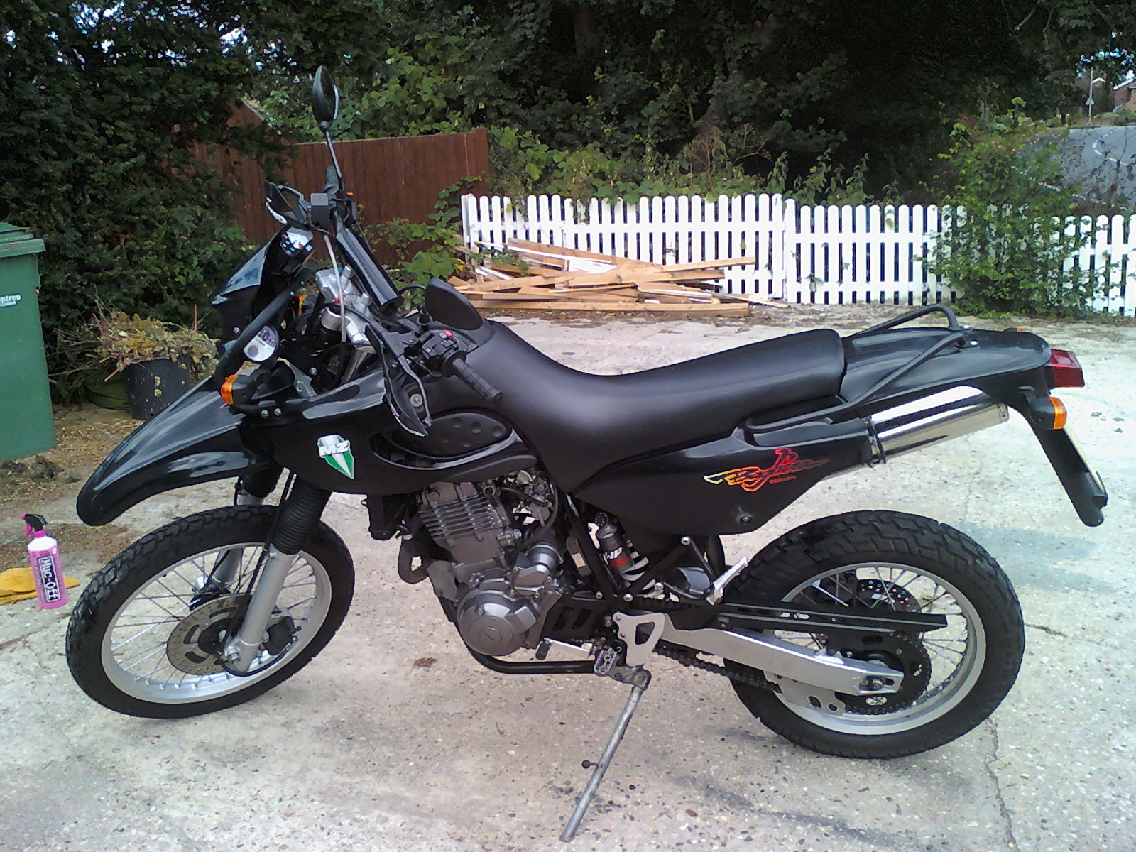

Postby handsomejackuk » Tue Aug 03, 2010 5:59 pm
Hi,
love my BSM Vampire, makes a great noise, loads of power, and have the convenience of popping in the DB killer when i want to reduce the noise...
Also nice and high up fitting close to the body, solid constructed end can, not yer typical aluminium end can real well built piece of kit. Glad i went for this, and some of the other end cans look too long and seem to stick up at the wrong angle.
Highly recommend this Exhaust system if you can get it...
just look how tight this is tucked in to the rear fender and correctly proportioned to the rest of the bike...
Al..

Yes, true. Most others do not look right. And stainless generally better than Al offroad exhausts. If you look at FMF exhausts...or KTM exhausts after a while, they look shabby. Even hot car exhausts look good even though you can hardly see them.
Is that breather/filter there on the carb?

I agrree with the positioning of your silencer. It does look better than mine but then im not dissapointed with how mine has turned out. The exhasut does look more in proportion when im sitting on the bike i have found.
One question for you how did you sort out the tail tidy for your bike. Im after a similar look to that but theres no aftermarket tail tidy for the baghira.
