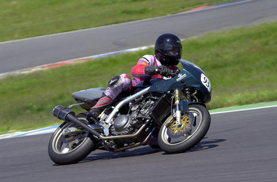

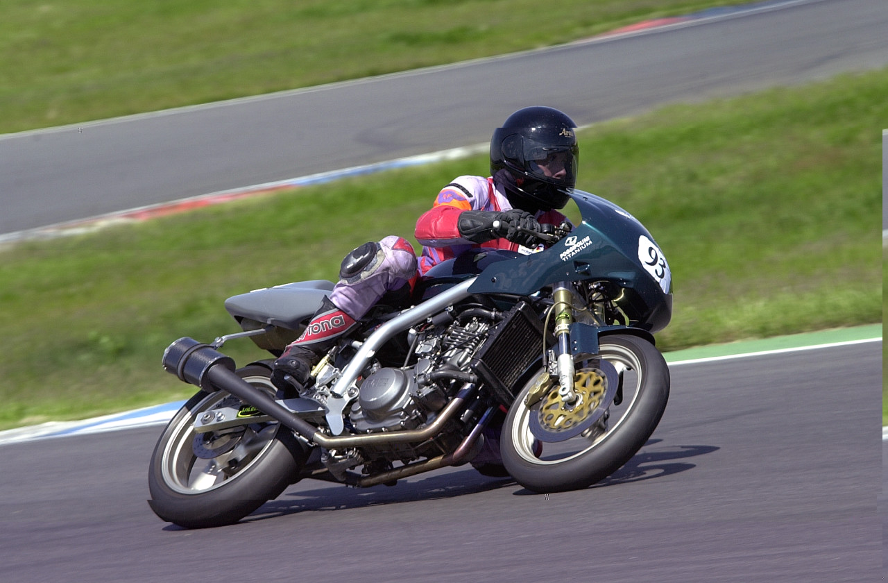

Postby Bill Jurgenson » Fri May 28, 2010 3:32 am
Almost ANY wheel would be better than the Grimca crap MZ used.
The tragedy of it is that the prototypes had both the fork and Brembo wheels and brakes from the TZ250. Then some fool had the idea that the Skorpion had to be sidecar-ready so they went fro the those lead-heavy and supposedly stronger wheels. Ther are not strong, however, on the contrary, the front rim dents much more easily than a much lighter Brembo as I know from personal experience.
In the states, the easiest way up front is to fit an early R6 fork complete with wheel and calipers. The early R6 had a 41mm USD fork so it goes right into the original yokes. It is adjustble and has a much better wheel. Of course there are other good 41mm forks out there.
For the rear, the swing arm from the same model R6 can relatively easily be modified to fit the Skorpion. That gives you a better aluminum swingarm and a much better and plentiful rear wheel.
This sort of change over gives you modern usable widths for racing: 3.5" and 5"
At the Yahoo MZOG (MZ owners group) you'll find photos and info on this reworking of the swing arm.
There are no wheels that fit plug and play. Unless you change everything as above, you will need to make spacers.
Be sure to get the rear caliper and plate that goes with the rear wheel you eventually decide to use. That ensures that the wheel, rotor and caliper will fit easily and be easily replaced. You then only need to make the spacers to the swing arm. The entire unit cushdrive/wheel/brakeplate+caliper can remain as is.
Don't bother to try a Ducati Monster rear as it is not possible to fit and AND get the chain to line up - I tried.
Personally, I would go for Marvic magnesium wheels, at the front there is one with the requisite width for the caliper(s). The rear wheel only has a bearing housing on the left. The right bearing is carried by abolt-on adapter ring for the rotor.
I used Marvics myself in my racer and the difference in handling and acceleration and braking is otherworldly. Of course any lighter wheel is a big improvement.

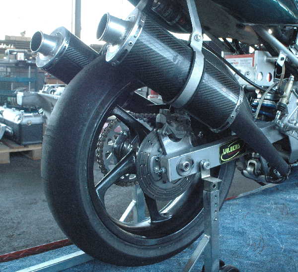

here is the rear wheel utilzing the rotor and Paioli brake plate from Yamaha:

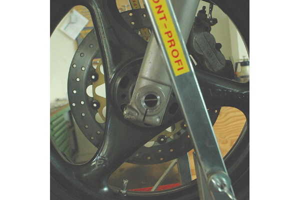

The front is completely uncomplicated:
I made a new hollow front axle that needs no spacer at the left and does not protrude from the fork leg. the previously used Yamaha 17mm front axle would have worked of course. The right leg has M16 thread so the Yamaha axle turns right in. The 25mm Ø left fork clamp is the same as Yamaha uses. Since none of the Brembo wheels fit the RSU fork together with the speedo drive, a replacement spacer is needed to take of the vacant space. I simply make a a 78mm long single spacer from 25mm aluminum tubing drilled and reamed out to 17mm to fit the Yamaha axle. The Yamaha axle is hollow, too.

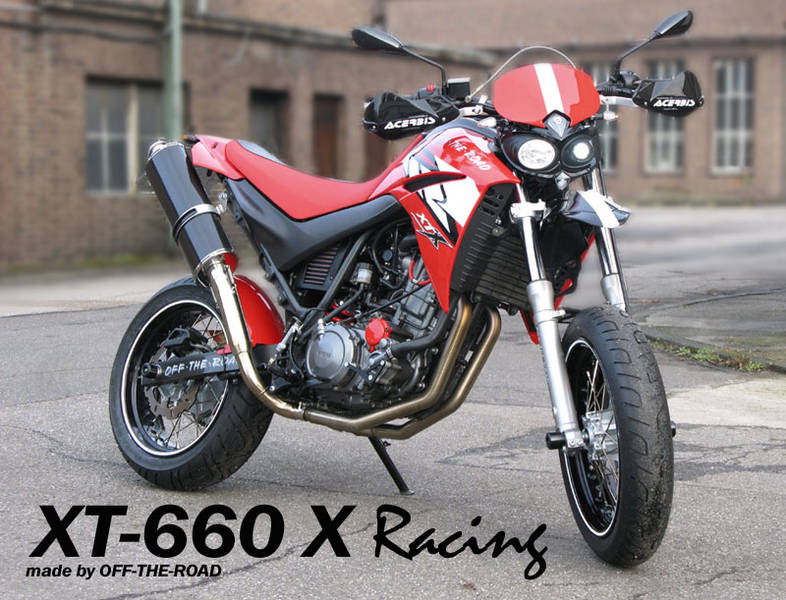

What sort of exhaust system are you going to run? I am looking for a system 2-1 for mine with larger headers,havent found one as yet
although Offtheroad.de has a system for the new 660 that may fit...let us know cause there are some of us that would like to change
this. Tim Barker made 2-2 at one time...

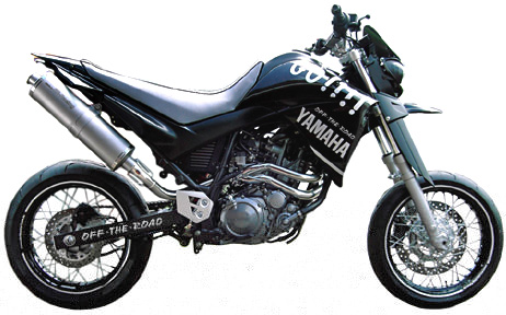

http://www.Offtheroad.de/
I assume you mean this one:
It will probably fit without too much trouble.
I use one like this which fits almost as if it was made for the bike:
but this one will not fit the XTZ head. The ports of the aircooled head are almost parallel, unlike those of the XTZ. I don't know how strongly the ports of the XT660 are splayed but they are angled as well so it shouldn't be a big problem. You will have to move the radiator out in any event.
The also supply headers which the combine with 2 cans to make a 2 in 2:
The headers will present no problems but the connetcing pipes will need extensive rebending to make them fit a road racer.
I would pester Tim Barker who is in the exhaust business and has experience making racing systems for the Skorpion and the SZR.
I used a Barker 2 in 2 myself.

As for the Barker pipes, they cannot possibly extended beyond the rear wheel originally simply because nothing may extend beyond the rear wheel by international race regulations.
google european supermono (ESA)
all serious big bore contenders including OVER and Slipstream run some sort of 2 in 2 extend as far back as possible.
Length is necessary for such a low RPM large capacity cylinder to make use of the resonance.
To a certain extent, larger Ø and taper can shorten the caculated length and that makes the 2 in 2 better as the combined section of the two headers and megaphones larger than a reasonable 2 in 1 could be. Dyno tests consistently show that the 2in 2 works better.
So be aware that your cosmetic "improvements" will rob you of power the 2 in 2 was made to get.
