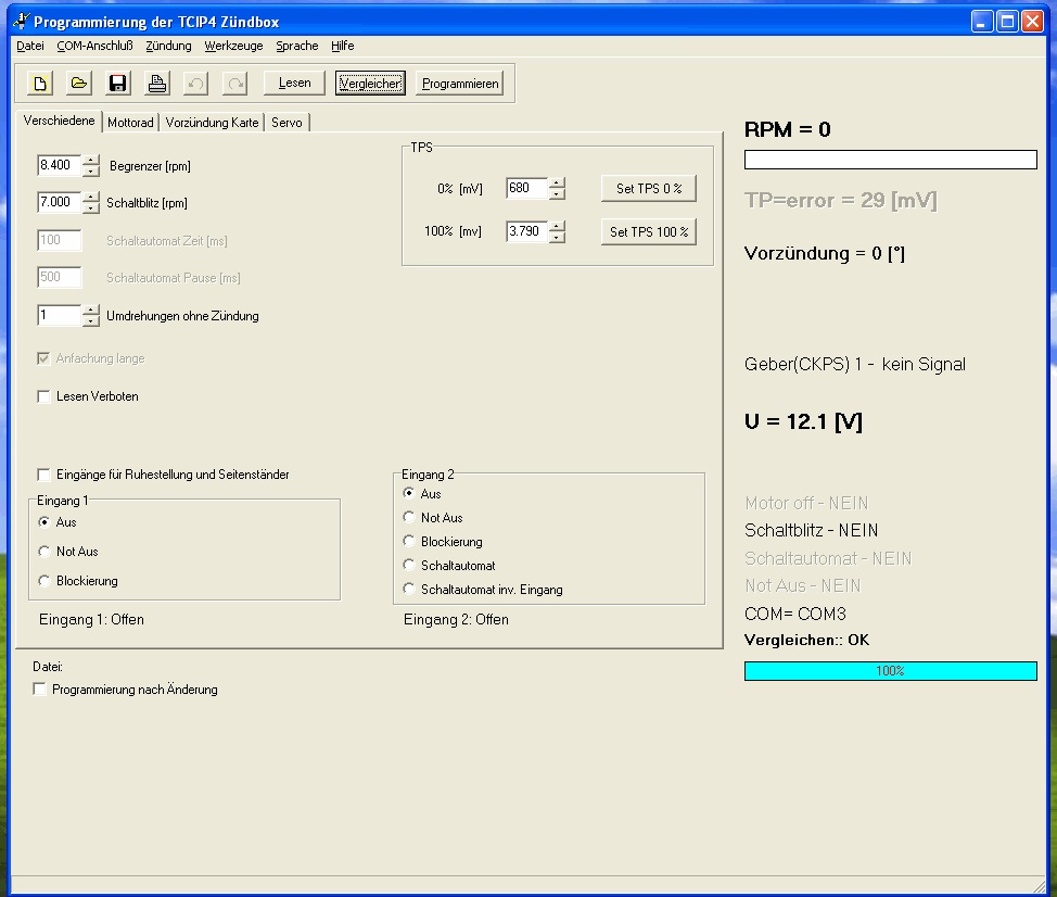

Having sold over 50 Sparkers to various customers all ober Europe, A word of warning, tho. As shipped by Ignitech, the bike will not start with the Sparker.
You must change the setting on the first page of their SW:
turn off the connection for sidestand etc as above.
The supplied curve is not good, either, but you can change that - or write me a mail and I will send you one that does work.
