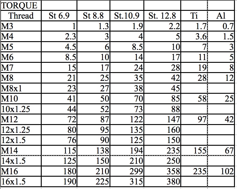

Do NOT use Loctite. Use Schnorr saftey washers and the proper torque for the M8 bolts.
obviously in meter/kilogram, not in foot/pounds.
Also use a correct thread grease or the torque wrench is just stage prop.
The Loctite used in industrial assembly is pre-applied and dry. It functions both as a torqueing lubricant and after setting again as an adhesive.
