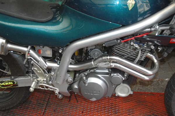

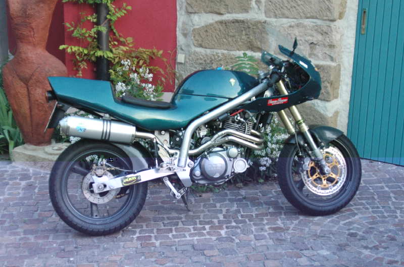

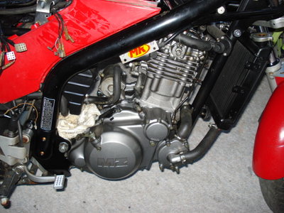

The home-made 2-1 I referred to was like this; similar but of larger Ø that the original and, above all, routed under the bike so it could not possibly ground. the centerstand must beromved along with its right bracket for this. The Cup has no center stand.
my racer in its first form.
my street bike until I rebuilt it for a friend as a track bike. It has the REMUS system
Like my own, this has 32mmID (OEM=28mmID) headers leading into a much larger collector. It is also longer than the OEM system. 100 of these were made; they do occasionally pop up on eBay in Holland and Germany. Remus has two standard cans that fit, a refractor(civilized) and an absorber(loud). I had both, one for MOT and one for real-life.
BTW, this bike has dual TM38 with open stacks, a one-off aluminum seatframe (black anodized), Marvic mag wheels and ...
XTZ headers will also work as will probably those for the Baggi but these are scrambler-type headers and it is a VERY CLOSE fit.

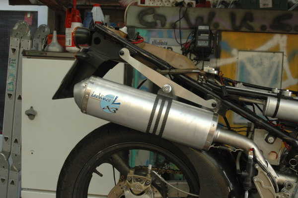

I have a SRX/TT cylinder and head on my XTZ bottom end in my own Skorpion:
You can see the 35mm headers from Devil in France (well done, all slipon joints with springs) and the matching LeoVince can also for the TT. Believe it or not, this stuff fit out of the box just as you see it!
BTW, the Gilles rearsets are officially available (from any dealer or from GIlles or from me) for the Skorpion (my doing): AS31-MZ01R; they are plug and play.
I needed only to make a decent bracket for the can.
I am reasonably sure that the XTZ/BAGGI stuff will also work like this BUT they will not clear the radiator in the original position. Mine is aircooled.
