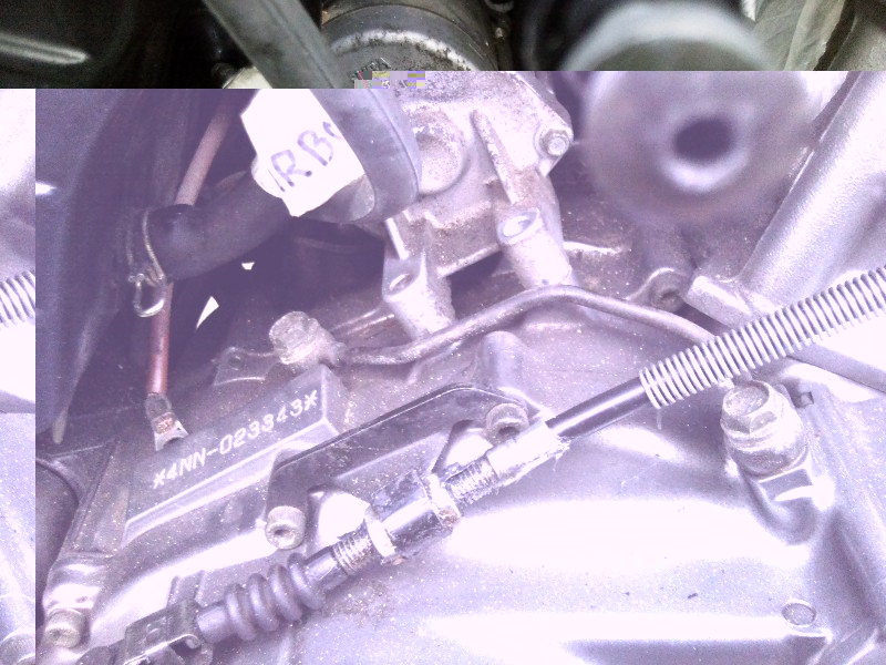

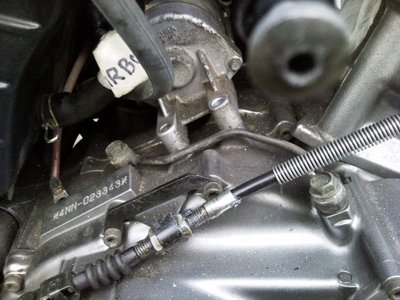

Postby djsbriscoe » Mon Mar 15, 2010 11:55 am
Hi,
Can the oil pipe behind the starter motor be removed safely without any other work needed. I'm assuming that oil can't be drained as the engine is a dry sump type. The pipe is blocking the removal of the motor by sliding it backwards.

Postby Bill Jurgenson » Mon Mar 15, 2010 12:02 pm
assuming you mean the black steel pipe (feed to 5th gear) on the right, yes, you can simply take it off.

Postby djsbriscoe » Mon Mar 15, 2010 12:34 pm
Hi,
This is the pipe
Is it safe to remove the pipe behind the starter?
