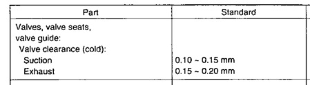

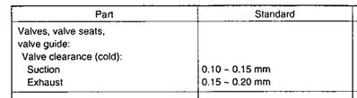

Yamaha workshop manual
This should equate (if I did my math right) to 0.004" in and 0.006" out.
You need a 10mm box wrench for the lock nuts and 4mm openend (spanner for the Brits) for the screw itself.

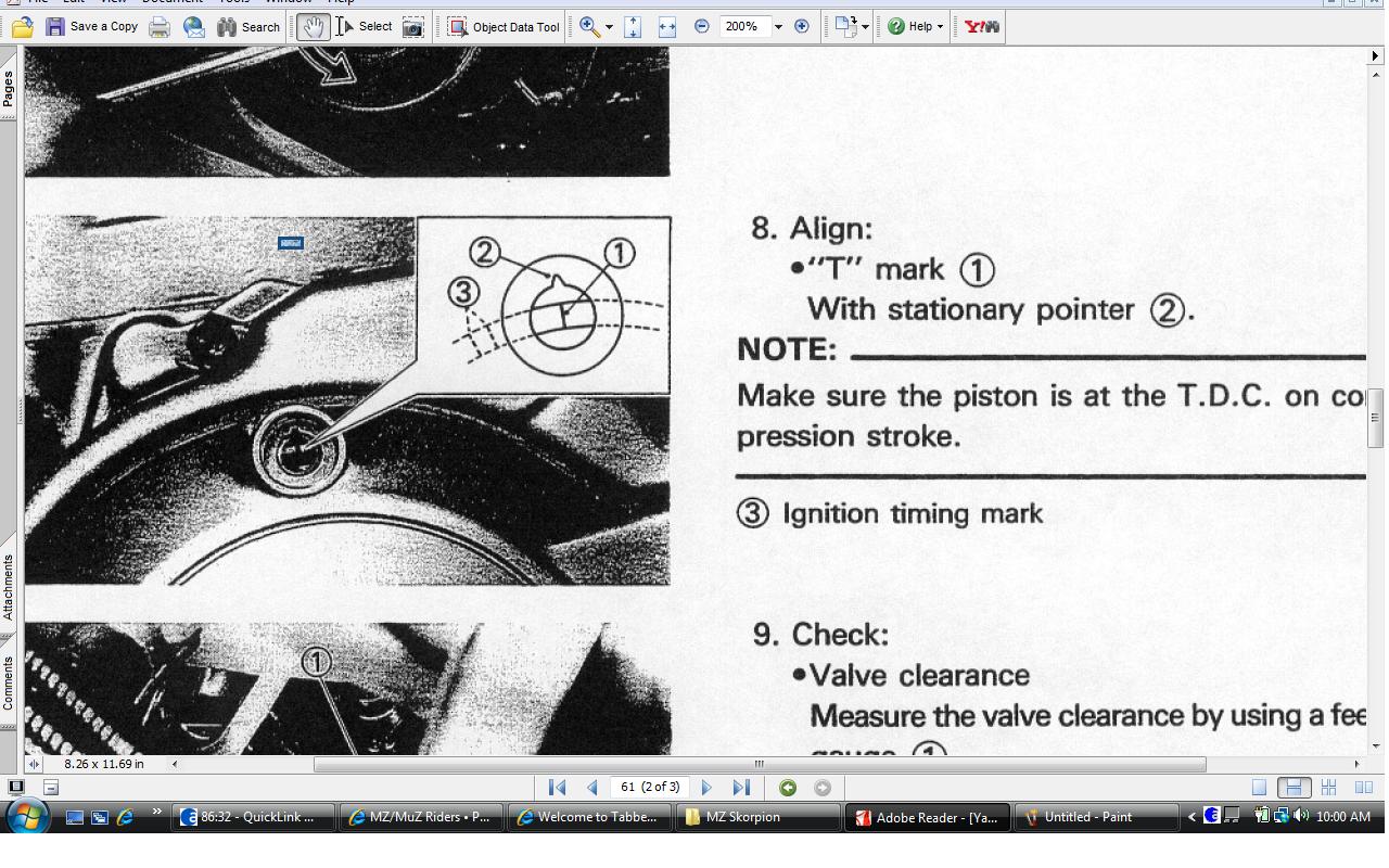

Thanks so much for the help BIll. I can see where the problem lies. I'm going by a link to the manual (see below) and it shows to line up the "T" mark on the flywheel. It sounds like your saying to use the middle mark? What I see on the flywheel looks like..... I--I I . Again manual says use the mark to the furthest right, are you saying use the middle mark? I think I've got everything else under control , just cant get TDC set correctly. Please advise all who have been beyond this point sucessfully.
one thing i know i was doing wrong was i was spinning the motor clockwise not COUNTERCLOCKWISE.... oops....
LINK TO XTZ 660 Valve Adjustment
http://www.mzriders.com/download/file.php?id=1628

Postby Bill Jurgenson » Thu Oct 01, 2009 12:41 pm
There is no middle mark on my flywheels, nor anything that could be construed to be a letter. Just two indents as if made with a cold chisel.
Anyway, like I said you use the second one, the one to right since the motor turns counterclockwise.
Turn the crankshaft with a 19mm socket wrench counterclockwise until you see the second of the two timing marks on the edge of the flywheel.
