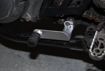

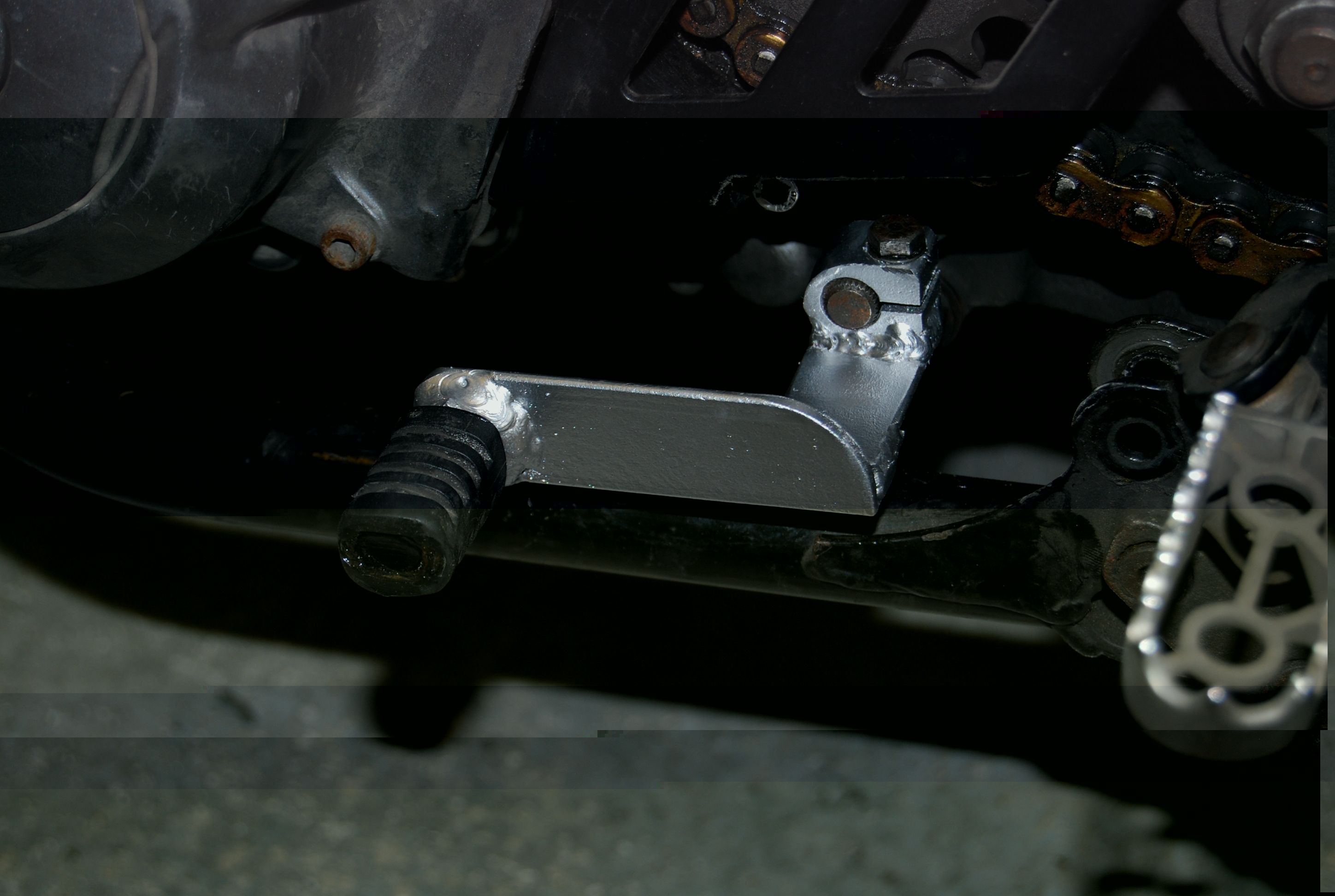

Postby BRAAAP ! » Sun Jul 18, 2010 1:16 pm
Hi, I've just broken my 2nd aluminium gear lever on my baghira, replacement cost is £55, you are having a laugh at that price. . .
I looked around on the tinternet for a universal gear lever (kawasaki kmx 125/250 ones look about right) but I couldn't find any dimensions so ended up making my own from the old bits and some angle iron.
Initial road tests seem ok.
