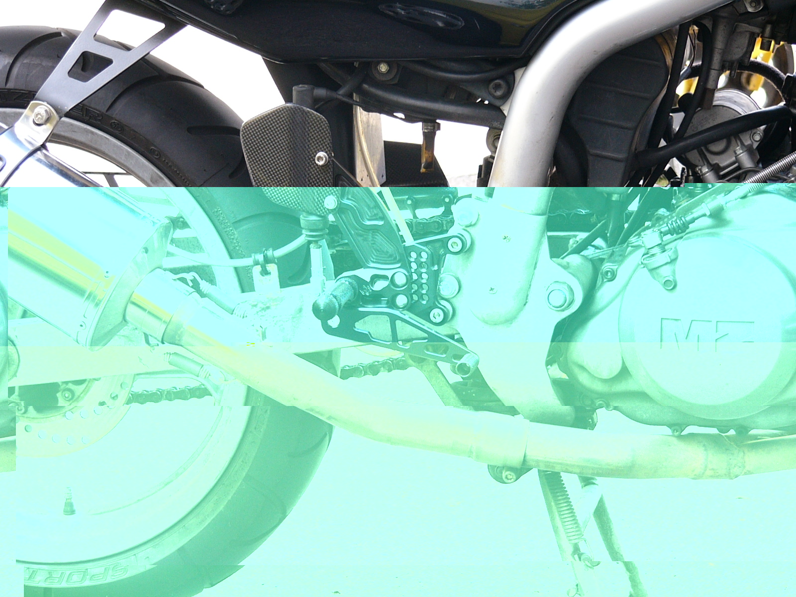

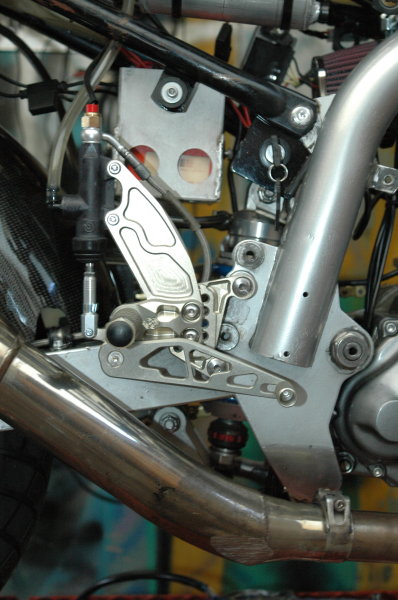

not sure why the hose and wiring shouldn't fit. The pump sits higher with the Gilles bracket so the wiring should be, if anything, too long.
This is a stock Skorpion with those black rearsets I sent to you by accident:
Ralf assured me no changes were made here. He wrote, it took him about 1/2h. to mount the Gilles.
He has an EGU can and connector pipe mounted but that makes no difference.

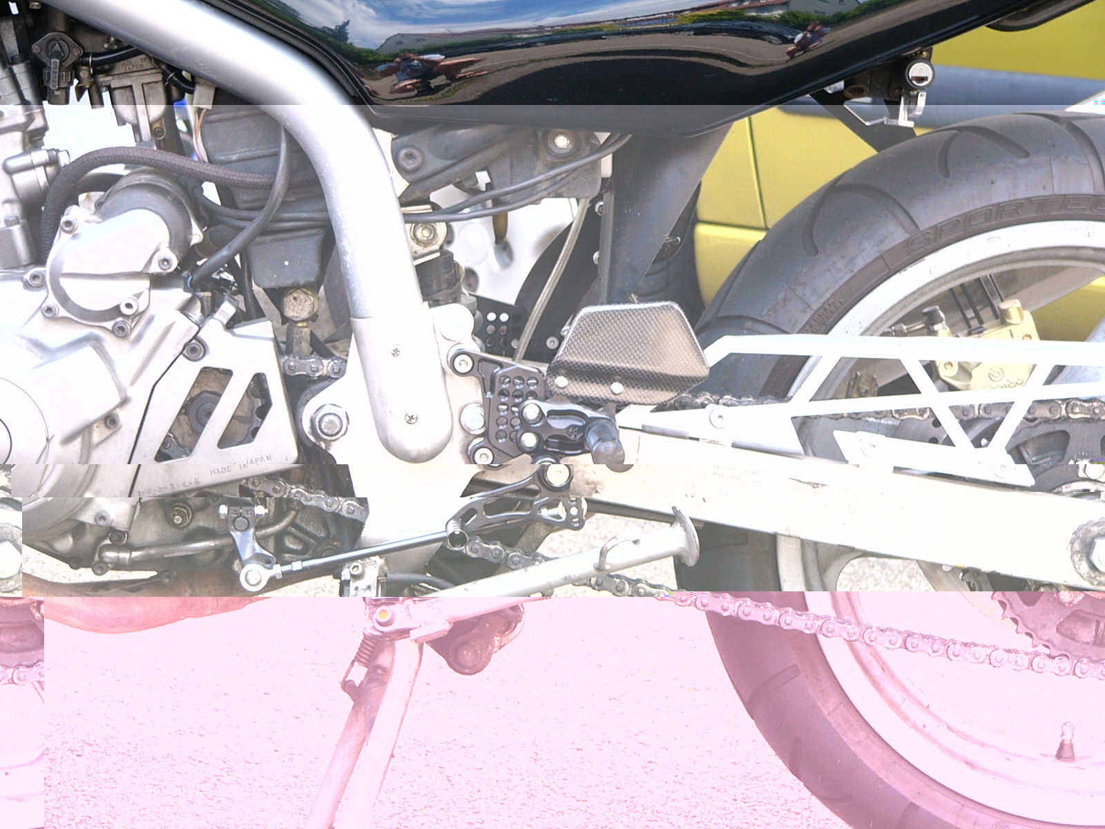

and the other side, just for the records:
I have an ABM steelflex line, tho that is not new or specific to the Gilles and a Brembo switch (typically Ducati) with cable, a modification I also did quite a while ago and did not need to change.
This puts the connecting plug up under the seat faring, away from immediate road water and dirt and boots, too. I always had trouble with those two sleazy flat connectors oxidizing and not making a connection, so the brake light do not light up. Of course, after a few "wiggles" the light worked again. BTW, I use the same hydraulic switch on the front pump, too.
