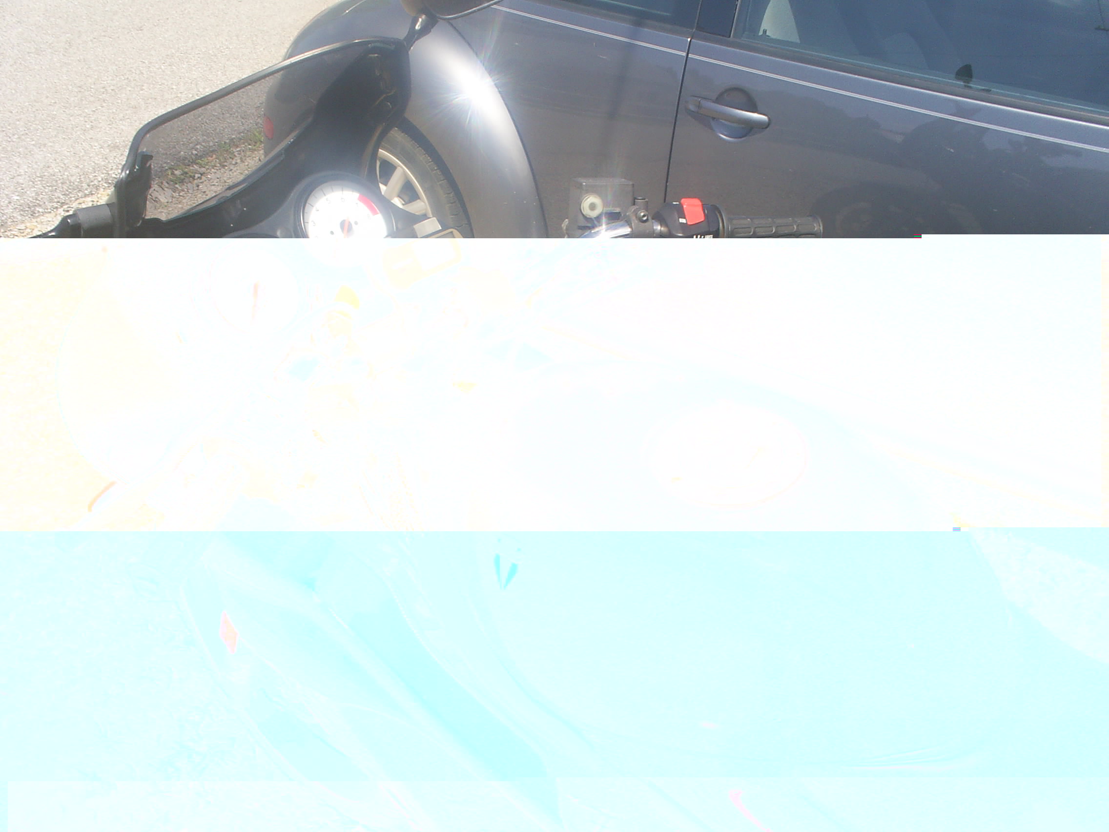

picture of my no cost change
the black brace in the middle is a piece of usa size gas pipe perfect fit
the gps mount is recycled alum plate
the holders for gps mount from a brace on a set of trail bike bars
and the brake line had to be unbolted from the fork and rerouted
electric wires required some rerouteing
handle bars recycled from my 95 saxon tour
cost me usd almost $7.00 for new watch band to hold gps on the bracket i made today
every thing else was recycled scrap or old used stuff from my spares bin
but a lot of shop time went into it----
the finished changes to bars
