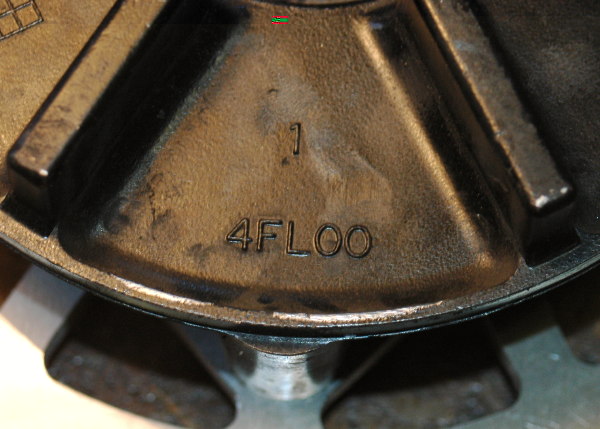

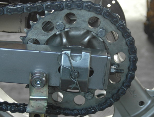

Rear: both late models use the same wheel: 3,5/17. You must get the chainwheel carrier(cushdrive) from the 4FL and not that of the 4DL. There are at least 3 different carriers for TZRs but only the 4FL fits the Skorpion.

The Yamahas, including bot the FZR and the SZR, use a 15mm rear axle, the MZ a 17mm. You have two options:
1)replace the two wheel bearings with 17mm ID and drill out all the OEM spacers (carrier-wheel inside-brakeplate) and the brake plate and use the MZ axle. Slight hitch here: the 17 ID bearings are 1mm narrower than the 15 ID which is no big deal beyond the fact the it slightly spoils the rotor/caliper alignment.
2)bush the chain tensioners down from 17 to 15mm and use a 15mm axle, leaving all the Yamaha stuff original.
You will have to make a new axle from 15 mm stock which is simple enuf; you only have to cut M14 threading at both ends after determining the length. The Yamaha axle is maddeningly just that much too short! I have used it once by making a special threaded clasp instead of using a nut.
I can definitely say it is not worth the effort. It does look good, tho.
I have done both ways several times and can sat from my experience that (2) is vastly preferable and simpler as well.
Preferable because all the parts are stock Yamaha except the two outside spacers. These are two simple bushings, at the left, the OEM SZR part an be reduced in width (±12mm) and used as is, at the right 4mm thick and at least 30mmØ, better 35. Make 3 of these and use the the other two as washers on the outside.
