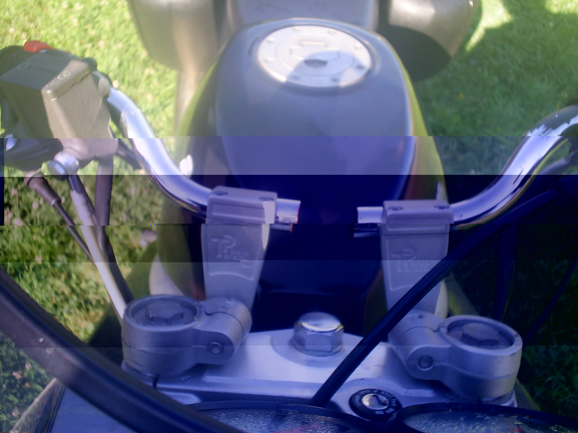

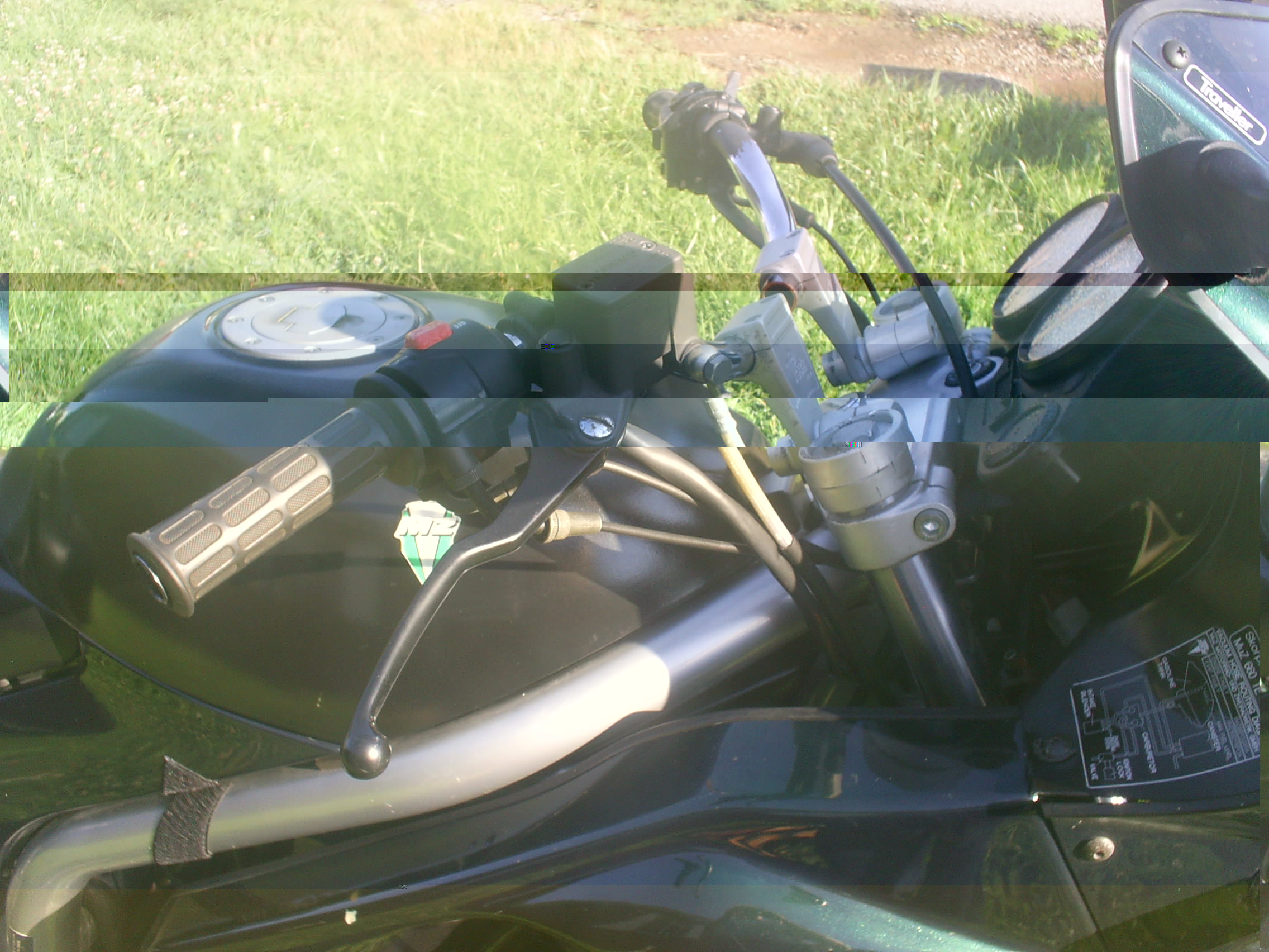

Postby DAVID THOMPSON » Sat Jun 27, 2009 8:10 am
here are pictures of my change
need to make a bar to insert in the gap left by the wider spacing
due to only way to get bars into risers
and need to ream out end of bars so the end weights can be refitted
no cables or hoses needed to be longer just rerouted a bit
and new guide holes for the electrical controls
the bars were stock bars from my 4 stroke saxon tour 1995
best way to see pictures is download them
and this is still a work in progress
dave t
ps made the bike drivable roads are in poor repair in my area and short clipons stink
